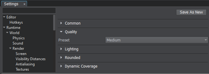

Quality#
Clouds quality rendering settings
Preset The index of the clouds quality preset used at the moment. One of the following values:
  • Low (by default)
  • Medium
  • High + Interleaved
  • High
  • Ultra + Interleaved
  • Ultra
  • Extreme + Interleaved
  • Extreme
  • Custom
Console access: render_clouds_quality_preset (API control)
Presets override user-defined custom settings. When any preset other than Custom is active, modification of the parameters via API has no effect. The parameter value set via the last API call shall be used only when the Custom preset is active. When checking the current parameter value via API, you'll get the corresponding setting stored in the active preset (default or custom one).

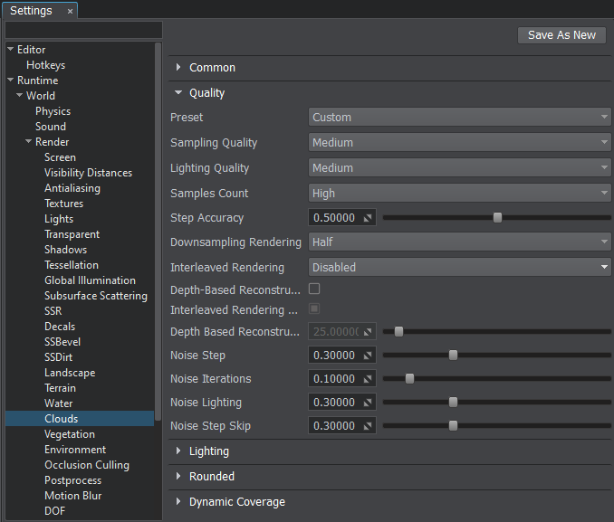

Customizable Settings#
Clouds quality custom settings
Clouds Quality Settings
Sampling Quality The sampling quality for clouds. This parameter sets the number of noise samples that affects the cloud shape processing quality. The higher the value, the less are visual artifacts. The following modes are available:
  • Low - 1 sample, low quality (higher cloud density)
  • Medium - 3 samples, medium quality
  • High - 5 samples, high quality
  • Ultra - 6 samples, ultra quality (lower density, the clouds are softer)
Visual difference between low and ultra quality is not significant. Therefore, it is recommended to use low settings, when possible, to gain performance.
Console access: render_clouds_sampling_quality (API control)
Lighting Quality The lighting quality for clouds. This parameter determines the number of samples used to calculate lighting for clouds. The following values are available:
This parameter has a significant impact on performance. Therefore, it is recommended to use low settings, when possible.
Console access: render_clouds_lighting_quality (API control)
Samples Count The number of samples used for clouds rendering. The higher the value, the less noise in clouds rendering. The following values are available:
Option #3 is selected by default (see above).
Console access: render_clouds_samples_count (API control)
Step Accuracy The accuracy of ray marching steps. This parameter enables you to improve the visual look of clouds when viewed from inside a cloud layer. It reduces the noise of lighting and clouds shape for long ray marching distances, adds some noise-based blur to a sharp border at the bottom sphere of the cloud layer (rounded) and removes popping effect when leaving a rounded cloud layer. Higher values provide more accurate form and less noise, while lower ones gain more performance.
Console access: render_clouds_step_accuracy (API control)
Downsampling Rendering The downsampling rendering mode for clouds. This parameter determines clouds resolution based on current screen resolution.
  • Full - full resolution
Console access: render_clouds_downsampling_rendering (API control)
Interleaved Rendering The interleaved rendering mode for clouds. In cases when clouds are viewed from the ground, or from above (at significant distance) and viewer's velocities are less than 200 units per second, this parameter can be used to provide a significant gain in performance. One of the following values:
  • Disabled (by default)
  • 2×2
  • 4×4
  • 8×8
Console access: render_clouds_interleaved_rendering (API control)
Depth Based Reconstruction The value indicating if clouds ray-marched depth is used for upsampling the downsampled clouds without obscuring the geometry and reprojection depending on the cloud depth. Recommended for flying through clouds.
Works only with the clouds downsampling rendering mode (see the CloudsDownsamplingRendering) set to half and/or the clouds interleaved rendering mode (see the CloudsInterleavedRendering) set to 2x2.
выкл. by default.
Console access: render_clouds_depth_based_reconstruction (API control)
Interleaved Rendering Temporal The value indicating if temporal accumulation of noises for interleaved sampling for clouds is enabled.
Works only when the clouds interleaved rendering mode (see the CloudsInterleavedRendering) is set to 2x2.
вкл. by default.
Console access: render_clouds_interleaved_rendering_temporal (API control)
Depth Based Reconstruction Threshold The depth threshold value for clouds depth-based reconstruction mode (see the CloudsDepthBasedReconstruction). This value defines the depth difference starting from which pixels are considered to be related to different surfaces.
Range of values: [0.0f, inf]. The default value is : 100.0f.
Console access: render_clouds_depth_based_reconstruction_threshold (API control)
Noise Step The value of the noise step parameter for clouds. This parameter determines the amount of jitter in the areas within clouds, that is used to reduce banding effect due to insufficient number of steps.
Range of values: [0.0f, 1.0f]. The default value is : 0.3f.
Console access: render_clouds_noise_step (API control)
Noise Iterations The value of the noise iterations parameter for clouds. This parameter determines the amount of jitter in the areas within clouds, that is used to reduce banding effect due to insufficient number of steps.
Range of values: [0.0f, 1.0f]. The default value is : 0.1f.
Console access: render_clouds_noise_iterations (API control)
Noise Lighting The value of the noise lighting parameter for the clouds. This parameter determines the amount of jitter for tracing steps of lighting calculation, that is used to reduce banding effect due to insufficient number of steps.
Console access: render_clouds_noise_lighting (API control)
Noise Step Skip The value of the noise step skip parameter for clouds. This parameter determines the amount of jitter in the areas between clouds, that is used to reduce banding effect due to insufficient number of steps.
Console access: render_clouds_noise_step_skip (API control)
