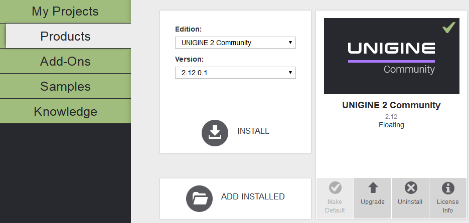

To start working, you should have a Product installed. In the Products tab, you can install a new version of a Product or add an already installed one.要开始工作,您应该已安装产品。在Products标签中,您可以安装产品的新版本或添加已经安装的产品。
- To install a new Product:
- Specify the Product type in the Edition field (Community, Engineering, Sim or Editor) in the Products tab.Specify the Product type in the Edition field (Community, Engineering, Sim or Editor) in the Products tab.
- Specify the Product version in the Version field.Specify the Product version in the Version field.
- Click Install. The installation progress will be shown under the menu on the left. The installed Product will appear in the Products list.Click Install. The installation progress will be shown under the menu on the left. The installed Product will appear in the Products list.
- Specify the Product type in the Edition field (Community, Engineering, Sim or Editor) in the Products tab.在Edition field (Community, Engineering, Sim要么Community, Engineering, Sim或Products tab.
- Specify the Product version in the Version field.在Version字段中指定产品版本。
- Click Install. The installation progress will be shown under the menu on the left. The installed Product will appear in the Products list.单击Install。安装进度将显示在左侧菜单下。安装的产品将出现在“产品”列表中。
