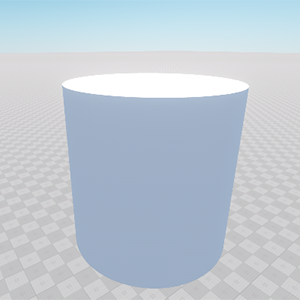

int addCylinderSurface ( const char * name, float radius, float height, int stacks, int slices ) #
Appends a cylinder surface to the current mesh. The stacks and slices specify the surface's subdivision.
// create a mesh instance
// add cylinder surface with the name "cylinder_surface".
// the radius of the cylinder is 1.0, the height is 2.0,
// stacks and slices are equals to 200 and 100, respectively
mesh->addCylinderSurface("cylinder_surface", 1.0f, 2.0f, 200, 100);
// create the ObjectMeshDynamic from the Mesh object
ObjectMeshDynamicPtr dynamicMesh = ObjectMeshDynamic::create(mesh);
// set the position of the mesh
dynamicMesh->setWorldTransform(translate(Math::Vec3(10.0f,10.0f,10.0f)));
// set the name of the mesh
dynamicMesh->setName("Dynamic Mesh");
The mesh will appear.
Arguments
  • const char * name - Surface name.
  • float radius - Cylinder radius.
  • float height - Cylinder height.
  • int stacks - Number of stacks that divide the cylinder radially.
  • int slices - Number of slices that divide the cylinder horizontally.
Return value
The added surface number.
