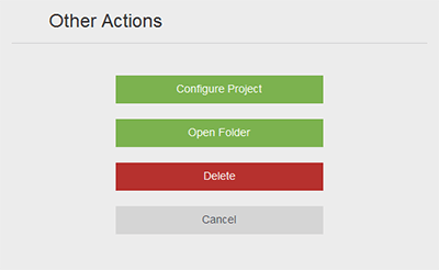

Other Actions
When clicking the Other Actions button, the following form opens:
Configure Project | Change project settings: the version of the release application, the coordinates precision and the general settings. Also this option should be used when you need to upgrade the existing project to the newest version of the SDK. |
Open Folder | Open the project folder. |
Delete | Delete the project. |
