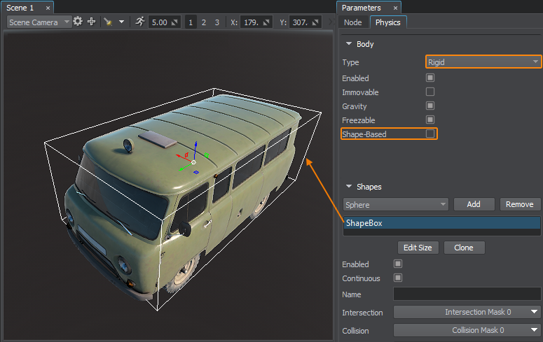

Step 4. Engage Physics#
Then, we should assign a rigid body to the object representing the vehicle's body and disable the Shape-Based option for it, to turn off automatic calculation as inertia, mass, and center of mass are specified in the component. Then, add necessary number of physical shapes to specify the geometry of the body.

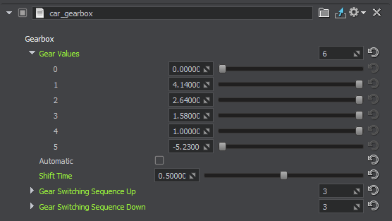

Gearbox#
Assign the car_gearbox component to the gearbox node. Here we set transmission type (MT or AT), specify all gear numbers and shifting time. This component also controls switching between the gears (AT), so for each gear we should set throttle and speed values for switching up or down to the next gear.
The array of gear values must contain at least 3 elements: neutral, first front, and rear. Tables describing Up and Down switching sequences should have the number of elements equal to the number of transitions: number_of_forward_gears - 1. For example, for a 3-speed gearbox we have:
  • 1 -> 2
  • 2 -> 3
Each element of the array should contain at least one Throttle-Speed pair for the corresponding transition.

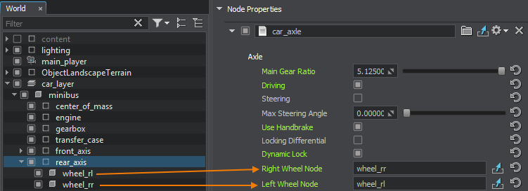

Axles#
Assign the car_axle component to all dummy nodes representing vehicle's axles (e.g. front_axis and rear_axis). You can create as many axles as you need. For each axle, attach nodes representing wheels as children, and specify them in the corresponding fields of the car_axle component.
Then specify if the axle is a steering/driving one, if it has a locking differentinal, etc.
