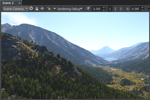

Rendering the Camera Viewport in a Separate Window
The view from each camera can be rendered into a separate Scene Viewport window.
To render a view from a camera to a separate viewport perform the following steps:
Add a new Scene Viewport window, choose Windows -> Add Scene Viewport.
A new viewport named Scene 2 will open.
New Scene Viewport -
Select the desired camera to render the view from in the drop-down list of the Camera panel.
NoticeYou can change the camera at any time if necessary.
The total number of viewports, that can be opened simultaneously, is not limited. Each new viewport window has the same functionality as the main Scene Viewport window.
You can use several Scene Viewports to operate with several nodes located far away from each other, or to view different orthographic projections of the scene (Top, Front, and Side views).
