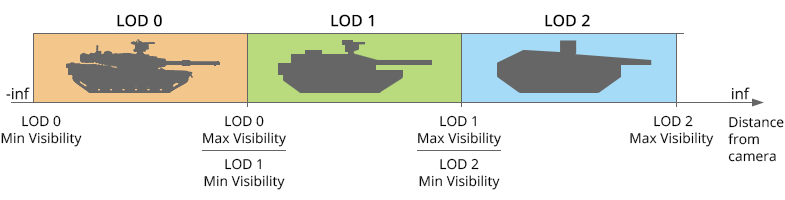

- Disable one LOD and enable another at the specified distance defined by two values: maximum visibility distance of the first LOD (Max Visibility) and minimum visibility distance of the second LOD (Min Visibility).

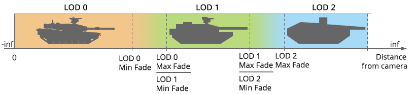

- Smoothly fade one LOD into another at the specified interval defined by two values: minimum fade distance of the first LOD (Min Fade) and maximum fade distance of the first LOD/minimum fade distance of the second LOD (Max Fade).

Visibility Distances | The LODs visibility parameters are defined by the visibility range. It is set by two parameters: the minimum visibility and maximum visibility distances measured from the camera. If the surface is within the range specified by these bounds, it is displayed, otherwise, it is hidden.
Ranges for surfaces that represent different LODs of the same object should not overlap. |
Fade Distances | Discrete LODs are likely to have one noticeable and quite distracting artifact - "popping", when one LOD is switched to another. Rather than abruptly switching the LODs, they can be smoothly blended into each other over a fade distance making the transition imperceptible.
Smooth LODs with alpha-blend fading are available only when
render_alpha_fade is set to
1 (which is set by default). Just like visibility distances, the range of the fading region is defined by the minimum fade and maximum fade distances:
Although alpha blending between the LODs looks by far better, it also means that within the fade region two versions of the same object are rendered at the same time. For this reason, the fade region should be kept as short as necessary. |

- We want the switching distance at 50 units. For that, we need to "dock" visibility distances of surfaces to each other:
- Our first LOD surface surface_lod_0 should be always presented when the camera is close to the object. So, the minimum visibility distance is set to -inf. And 50 units from the camera will be the maximum visibility distance for it.
- Directly following it, comes the second LOD surface surface_lod_1. It is visible from 50 units (which is the minimum visibility distance) - and up to infinity (the maximum visibility distance = inf).
- Now the LOds are switched but sharply rather then smoothly. To be smoothly blended, the symmetrical fade-out (for the 1st LOD) and fade-in (for the 2nd LOD) distances are set. Let's say, the fading region should be 5 units.
- For the 1st LOD to fade-out, its maximum fade distance is set to 5.
- For the 2nd LOD to fade-in, its minimum fade distance is also set to 5.
In the result, the LODs will be changed in the following manner:
From the BB of the object
to 50 units |
Only the 1st LOD surface surface_lod_0 is completely visible |
50 — 55 units | The 1st LOD fades out, while the 2nd LOD fades in |
From 55 units and further | Only the 2nd LOD surface surface_lod_1 is completely visible |

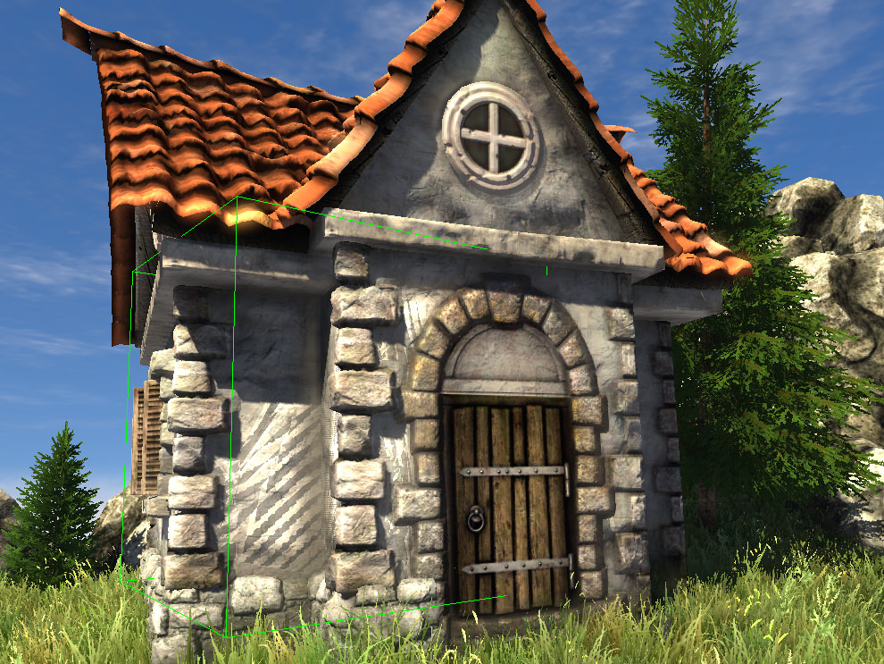

Let's take a model of the house, for example. When the camera is close by, the high-poly detail surfaces are seen, such as the door arch, stone corners, round window and roof tiles. When we move away, all these surfaces should be simultaneously changed by one united low-poly LOD surface.
![]() High-poly model
![]() Low-poly model to be used as distant LOD
The problem is, all this detail surfaces have different bounding boxes. So if their distances are checked for themselves (0 as min and max parents), we can have a situation when LODs of different parts of the house are turned on (or off) unequally, because their bounding boxes will be closer to the camera. This may cause z-fighting artifacts. Here the distant corner has not yet switched to a more detailed LOD, while the close one is drawn twice: as a high-poly corner LOD and at the same time the united low-poly house LOD.
If we set a bounding box of the whole house to be a reference object (min and max parent to 1), all surfaces will switch on simultaneously no matter what side we approach the house from.

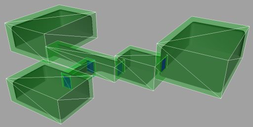

Often, it is enough to create and display to the user only a part of an artificial world, in a form of a labyrinth-like series of rooms and passages between them. Parts of open space, if they are present and do not spread at infinity (if they are confined areas), can also be considered "rooms". These limitations make such world ideal for being viewed as a set of sectors and portals.
The whole space is partitioned into convex areas called sectors ("rooms"). If there is some opening - a door or a window - between two adjacent sectors, through which one sector can be partially seen from another, this opening is called a portal. The sectors and portals help the renderer to determine, which areas and objects are visible from any given point in the world. Also, if a neighboring sector is seen through a portal, this portal is used as a viewing frustum for the area it leads to, allowing viewing frustum culling.

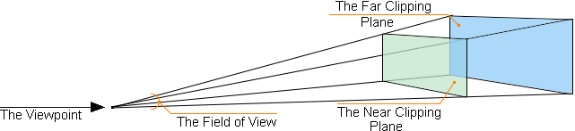

Perspective Projection
When the human eye views a scene, objects in the distance appear smaller than objects close by - this is known as perspective. While orthographic projection ignores this effect to allow accurate measurements, perspective definition shows distant objects as smaller to provide additional realism.
A viewing frustum (or a view frustum) is a field of view of the virtual camera for the perspective projection; in other words, it is the part of the world space that is seen on the screen. Its exact shape depends on the camera being simulated, but often it is simply a frustum of a rectangular pyramid. The planes of the viewing frustum that are parallel to the screen are called the near plane and the far plane.
As the field of view of the camera is not infinite, there are objects that do not get inside it. For example, objects that are closer to the viewer than the near plane will not be visible. The same is true for the objects beyond the far plane, if it is not placed at infinity, or for the objects cut off by the side faces. As such objects are invisible anyway, one can skip their drawing. The process of discarding unseen objects is called viewing frustum culling.

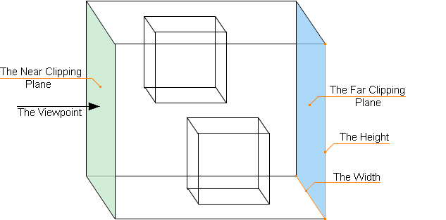

Orthographic Projection
When the human eye looks at a scene, objects in the distance appear smaller than objects close by. Orthographic projection ignores this effect to allow the creation of to-scale drawings for construction and engineering.
With an orthographic projection, the viewing volume is a rectangular parallelepiped, or more informally, a box. Unlike perspective projection, the size of the viewing volume doesn't change from one end to the other, so distance from the camera doesn't affect how large an object appears.
