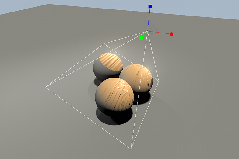

Projected Decal with normal map.

Projected Decal is a decal projected onto a surface by means of the perspective projection.
