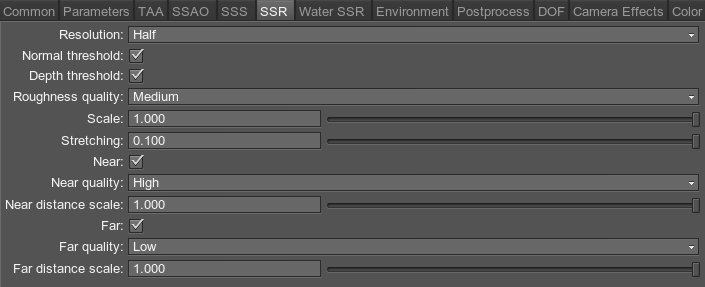

The tab contains settings that control screen-space reflections (SSR).
Resolution | Specifies the resolution of the SSR:
Can be controlled by render_ssr_resolution
console command. |
Normal threshold | Limits blur of screen space reflections (calculation of SSR roughness) by normals.
Can be controlled by render_ssr_normal_threshold
console command. |
Depth threshold | Limits blur of screen space reflections (calculation of SSR roughness) by depth.
Can be controlled by render_ssr_depth_threshold
console command. |
Roughness quality | Specifies the current quality of screen space reflections roughness:
Can be controlled by render_ssr_roughness_quality
console command. |
Scale | Controls the scale of the SSR within [0;10] range. |
Stretching | Controls the stretching factor of the SSR within [0;10] range. |
Near | Enables screen space reflections calculation for the near view.
Can be controlled by render_ssr_near
console command. |
Near quality | Specifies the quality of screen space reflections rendered at the near view.
Can be controlled by render_ssr_near_quality
console command. |
Near distance scale | Specifies the scale of the rendering distance of the near view for SSR.
Can be controlled by render_ssr_near_distance_scale
console command. |
Far | Enables screen space reflections calculation for the far view.
Can be controlled by render_ssr_far
console command. |
Far quality | Specifies the quality of screen space reflections rendered at the far view.
Can be controlled by render_ssr_far_quality
console command. |
Far distance scale | Specifies the scale of the rendering distance of the far view for SSR.
Can be controlled by render_ssr_far_distance_scale
console command. |
