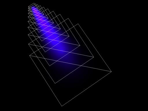

Projected volume is rendered as a simple particle system. It is a number of billboards, where each following billboard is bigger than the previous one.
Billboards of a volume projected object

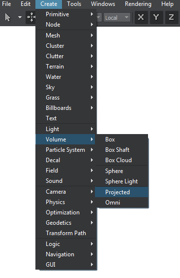

To create a Projected object, perform the following steps:
- On the Menu bar, click Create -> Volume -> Projected.
- Place the Projected object somewhere in the world.
- Specify the Projected object parameters.

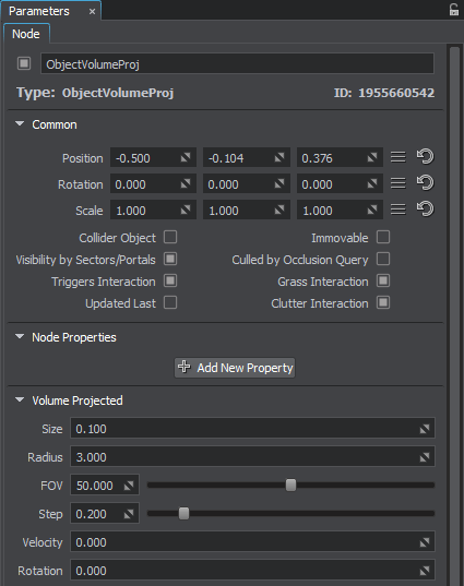

In the Volume Projected section (Parameters window -> Node tab), you can adjust the following parameters of the volume projected object:
Size | Size of the smallest billboard in units. By the minimum value of 0, the volume projected is not rendered at all. |
Radius | Length of the light beam along the Z axis in units. |
FOV | Width of the light beam. It is specified as the angle of the beam cone (in degrees).
Step | Distance between neighboring billboards.
Velocity | Velocity with which billboards move to the end of the beam (along the Z axis). |
Rotation | Angle of billboards rotation (in degrees). This angle is set for the billboard at the end of the beam.
