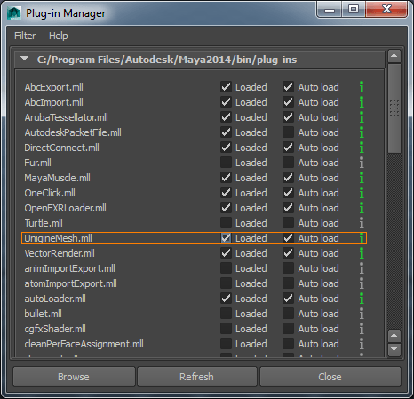

- Run Maya.
- Choose Window -> Settings/Preferences -> Plug-in manager in the Maya main menu.
Set Loaded and Auto load flags for UnigineMesh plugins.
Loaded and Auto load flags checked for the UnigineMesh.mll
