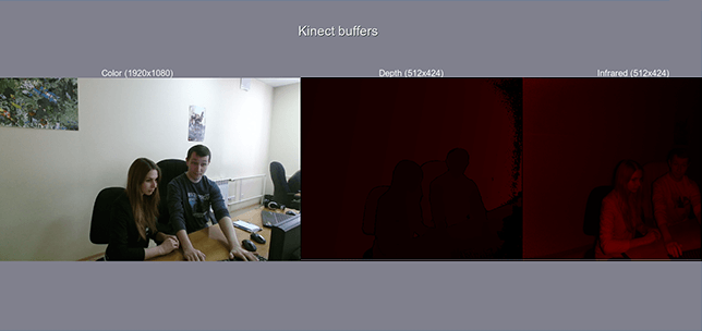

kinect_00 Sample that shows Kinect buffers: color, depth, and IR range

- <UnigineSDK>/data/samples/plugins/kinect_00 that shows all 3 buffers (color, depth, IR range).
