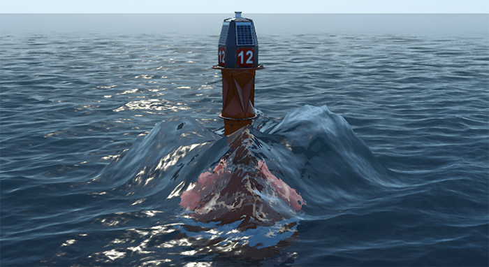

Water disturbance near the buoy is made by using FieldHeight object.

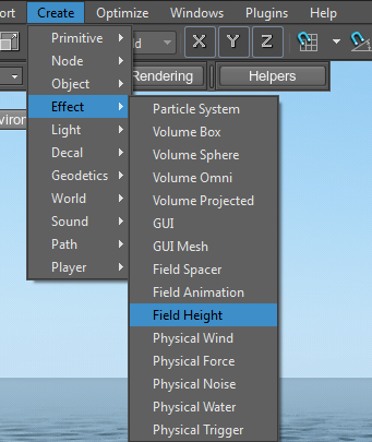

To add a height field in the world via UnigineEditor, do the following:
- On the Menu bar, choose Create -> Effect -> Field Height.
- Place the height field in the world so that it intersects Global Water object.

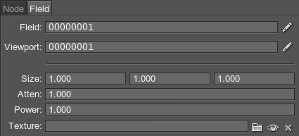

On the Field tab of the Nodes panel, the following parameters of the height field can be adjusted:
Setting Bit Masks
Field | A field mask. A bit mask that specifies an area of the height field to be applied to water. The height field will be applied to water only if they have matching masks. |
Viewport | A viewport mask. A bit mask for rendering the height field into the current viewport. For the height field to be rendered into the viewport, its mask should match the camera viewport mask. |
Setting Height Parameters
Size | Size of the height field along the axes in units. |
Atten | An attenuation factor indicating how much global water object's heights gradually changing from the center of the height field.
Power | Power parameter is a multiplier for FieldHeight's heightmap texture values.
Texture | Heightmap R16 or R32F (1-channeled) texture (controlled by the render_field_precision console command). Heightmap texture is used to create an additional height displacement for water surface. |
