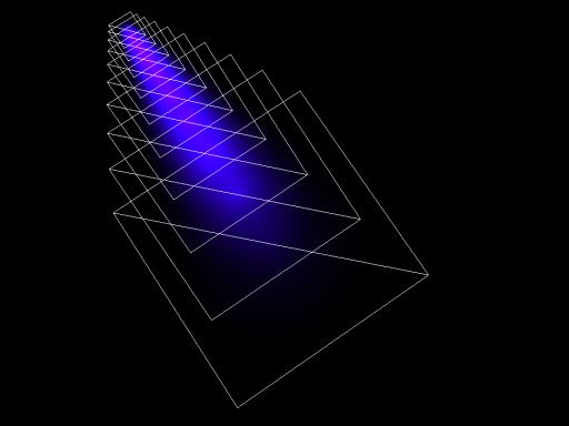

Projected volume is rendered as a simple particle system. It is a number of billboards, where each following billboard is bigger than the previous one.
Billboards of a volume projected object
