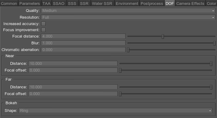

DOF
This tab contains settings used to control the depth of field (DOF) effect.
To enable the depth of field effect, use the render_dof 1 console command.
Quality | Specifies the quality of the depth of field effect
Can be controlled by render_dof_quality
console command. |
Resolution | Specifies the resolution of the depth of field effect:
Can be controlled by render_dof_resolution
console command. |
Increased accuracy | Enables increased accuracy for DOF effect. Enabling the parameter allows for increasing accuracy of focusing calculation.
Can be controlled by render_dof_increased_accuracy
console command. |
Focus improvement | Enables the focus improvement for DOF effect. When enabled, transitions between the focused and unfocused parts of the scene become more accurate.
Can be controlled by render_dof_focus_improvement
console command. |

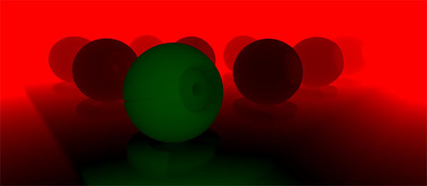

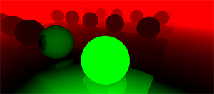

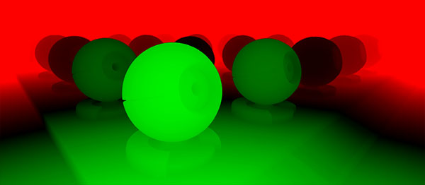

Focal distance | Specifies the focal distance. | ||
Blur | Specifies the intensity of the DOF blur. | ||
Chromatic aberration | Sets the intensity of chromatic aberration effect. | ||
Near
Distance |
Specifies the distance from focal to the most blurred zone to near.
Near
Focal offset |
Specifies the offset from the focal to the nearest blurred zone. | ||
Far
Distance |
Specifies the distance from focal to the most blurred zone to far.
Far
Focal offset |
Specifies the offset from the focal to the farthest blurred zone. | ||
Bokeh shape | Specifies the shape of the Bokeh:
Can be controlled by the
render_dof_bokeh_mode console command.
