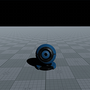

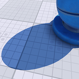

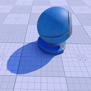

World Light Source
A world light is an infinitely remote light source casting orthographically projected beams onto the scene. The shadows cast by this light are parallel, which provides a realistic simulation of the sunlight.
World light shadows has an adaptive bias that is adjusted automatically on shadow maps applying: depending on the slope angle of the world light and its resolution, an offset of the depth value stored in the shadow map is calculated.

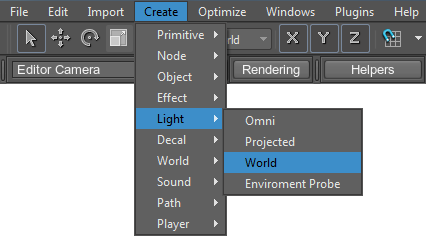

Adding World Light

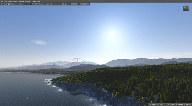

To add a world light to the scene via UnigineEditor, do the following:
- Run UnigineEditor.
- On the Menu bar, click Create -> Light -> World.
- Place the world light somewhere in the world.
NoticeThe physical position of the source is not important, only the direction matters, as it defines the shadow casting orientation. To change the light's direction use the rotation manipulator.
- Adjust the world light's settings.

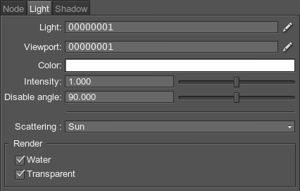

Light Settings
Light | A shadow mask. | ||||
Viewport | A viewport mask. | ||||
Color | A light RGBA color. | ||||
Intensity | A light color multiplier. | ||||

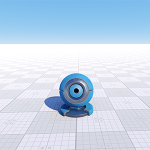

Disable angle | A critical angle above the horizon, where the light source is still enabled. If the light becomes disabled, it still affects scattering. | ||||
Scattering | A lighting type:

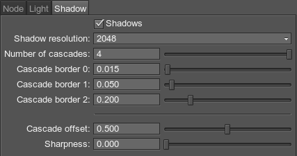

Shadow Settings
Shadows | Enables or disables the PSSM technique. | ||||||||
Shadow resolution | Size of the shadow map that defines shadow quality. | ||||||||

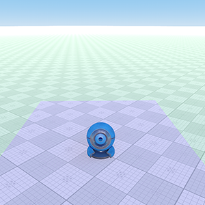

Number of cascades | A number of cascades with different shadow maps. Each cascade requires a separate rendering pass. All the shadow maps have the same resolution (the Shadow resolution parameter value), but are applied to different cascades. Thus, close-range shadows are of higher quality and distant ones of lower. The minimum number of cascades is 1, the maximum is 4. Increasing the number of cascades enhances the rendered image quality. However, at that, performance efficiency drops.
To visualize the cascades, enable Helpers -> Shadow cascades.

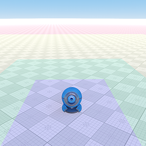

Cascade border | A multiplier for the distance to the border of the cascade in range [0;1]. The number of cascade borders depends on the number of cascades:
Cascade offset | Offset of the shadow cascades relative to the camera. The cascades will be shifted away from the camera. | ||||||||

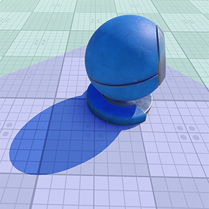

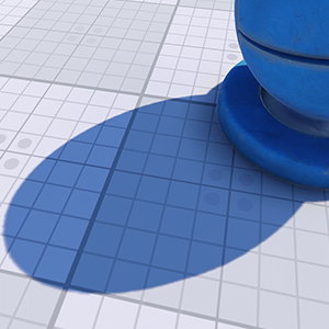

Sharpness | Sharpness of the shadow edges.
