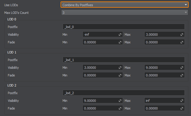

To create several variations of one object with different level of detail (LODs) you should have them as separate surfaces of the object. This will allow you to reduce the number of nodes in the hierarchy and simplify the settings of the LODs visibility.为一个具有不同详细程度的对象创建多个变体(检出限),则应将它们作为对象的单独表面。这将允许您减少层次结构中的节点数量,并简化LOD可见性的设置。
UNIGINE provides automatic assignment and configuration of Levels of Detail based on the name postfixes, enabling you to create and export different meshes for different LODs of your model in a single FBX file. When naming these meshes, you should add a postfix to specify the LOD each mesh represents. You can also specify visibility and fade distances for each LOD of your model at the importing stage, saving time, as you don't have to adjust these settings for the surfaces on the scene - choose Combine by Postfixes in the Use LODs dropdown.UNIGINE 提供基于名称后缀的详细级别的自动分配和配置,使您能够在单个 FBX 文件中为模型的不同 LOD 创建和导出不同的网格。在命名这些网格时,您应该添加一个后缀来指定每个网格所代表的 LOD。您还可以在导入阶段为模型的每个 LOD 指定可见性和渐变距离,从而节省时间,因为您不必为场景中的表面调整这些设置:在 Use LODs 下拉列表中选择 Combine by Postfixes
See the video tutorial on how to configure LODs for more details.看视频教程如何配置 LOD更多细节。
You can also enable the Merge Static Meshes option for more optimization.您还可以启用Merge Static Meshes选项以进行更多优化。
  1. The morph target import parameter that defines how the normals of the morph target are imported. Three modes are available:Use LODs 下拉列表中选择 Combine by Postfixes
    This will show additional LODs settings:这将显示其他LOD设置:
    Max LODs Count Number of Levels of Detail.详细级别数。
    Postfix Postfix added to the surface name to disambiguate the current LOD from other surfaces.在表面名称后添加后缀,以区分当前的 LOD 与其他表面。
    Min Visibility
    The minimum distance on which this LOD is visible in camera local axes.在摄像机局部轴上可见此LOD的最小距离。
    -inf — the LOD is visible by default.-inf:默认情况下,LOD可见。
    Max Visibility
    The maximum distance on which this LOD is visible in camera local axes.此LOD在相机局部轴中可见的最大距离。
    inf — the LOD is visible by default.inf:默认情况下,LOD可见。
    Min Fade
    Over this distance, the surface fades in until it is completely visible. Along this distance the engine automatically interpolates the level of detail from completely invisible to completely opaque. Fading-in starts when the camera has reached the minimum distance of surface visibility and is in the full visibility range.在这个距离上,表面逐渐消失,直到完全可见。沿着这个距离,引擎会自动将细节级别从完全不可见插入到完全不透明。当相机达到表面能见度的最小距离并且处于完整的能见度范围内时,淡入开始。
    Max Fade
    Over this distance, the surface fades out until it is completely invisible. Fading out starts when the camera has reached the maximum distance of surface visibility and is out of the full visibility range.在这个距离上,表面逐渐消失,直到完全不可见。当相机达到表面能见度的最大距离并且超出整个能见度范围时,就会开始淡出。
  2. Select the number of LODs that are stored in the FBX container.选择存储在FBX容器中的LOD数量。
  3. For each LOD, define a postfix that will be used to group objects in an FBX file into a corresponding LOD.对于每个LOD,定义一个后缀,该后缀将用于将FBX文件中的对象分组为相应的LOD。
    The postfix must be the same as the one used when creating objects in a 3D editor.后缀必须与在3D编辑器中创建对象时使用的后缀相同。
    The names of generated surfaces will be as follows: material_name + LOD_postfix.生成的曲面的名称如下:material_name + LOD_postfix
  4. Specify the minimum and maximum visibility and fade distances for each LOD.指定每个LOD的最小可见距离。每个LOD的最大可见距离等于下一个LOD的最小可见距离。最后一个LOD的最大可见距离等于inf

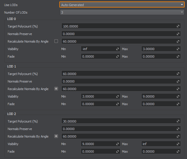

Automatic LOD Generation feature based on the meshoptimizer library will help in case you only have a high-poly model, saving you a lot of time on preparing levels of detail manually.自动 LOD 生成功能基于meshoptimizer 库将在您只有一个高多边形模型的情况下提供帮助,从而为您节省大量手动准备细节级别的时间。
To use the feature choose Auto-Generated in the Use LODs dropdown and configure the settings listed below - the Engine will do the rest, generating all LODs automatically based on your configuration.要使用该功能,请在 Use LODs 下拉列表中选择 Auto-Generated 并配置下面列出的设置 - 引擎将完成剩下的工作,并根据您的配置自动生成所有 LOD。
Number Of LODs Number of Levels of Detail.详细级别数。
Postfix Postfix added to the surface name to disambiguate the current LOD from other surfaces.Maximum number of vertices per mesh在表面名称后添加后缀,以区分当前的 LOD 与其他表面。
Target Polycount
Desired degree of geometry simplification for each LOD (target geometry complexity percentage from the initial number of polygons).每个LOD所需的几何简化程度(目标几何复杂度与初始多边形数量的百分比)。
Please keep in mind that this is only a target value, that in some cases may be unreachable for the mesh simplifier. In case any artefacts with the topology of the simplified meshes occur, try increasing this value.请记住,这只是一个目标值,在某些情况下,网格简化器可能无法达到。如果出现任何具有简化网格拓扑的伪影,请尝试增加此值。
Normals Preserve This parameter indicates the impact of normals on mesh topology simplification. Higher values increase the influence of normals, by the value of 0 normals are ignored. Avoid setting too high values as this may restrict simplifier too much and simplification will fail (as normals may differ significantly). Default setting is suitable for most cases.该参数表示法线对网格拓扑简化的影响。较高的值会增加法线的影响,0 的值会忽略法线。避免设置太高的值,因为这可能会过多地限制简化器并且简化将失败(因为法线可能会有很大差异)。默认设置适用于大多数情况。
Recalculate Normals by Angle Enables recalculation of normals in the process of mesh simplification based on the specified angle threshold. If an angle between the normals to adjacent polygons exceeds this value, normals will be recalculated between them to smoothen the look of the geometry and get rid of possible shading issues.启用基于指定角度阈值的网格简化过程中的法线重新计算。如果相邻多边形的法线之间的角度超过此值,则将在它们之间重新计算法线以平滑几何体的外观并消除可能的阴影问题。

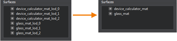

Surfaces of a single mesh generated instead of separate meshes with device_calculator and glass_mat materials assigned生成单个网格的表面,而不是分配了device_calculatorglass_mat材质的单独网格
You can also merge the surfaces having the same material assigned by enabling the Merge Surfaces by Materials option.您也可以通过启用Merge Surfaces by Materials选项合并具有相同材质的曲面。
Surfaces merged by materials材质合并的表面
