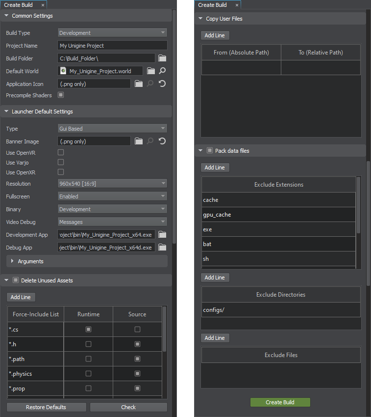

To create a final build for your project via UnigineEditor, perform the following:要通过UnigineEditor创建项目的最终构建,请执行以下步骤:
  1. In UnigineEditor, select File -> Create Build. The Create Build window will open.
    在UnigineEditor中,选择File -> Create BuildCreate Build窗口将打开。
  2. Specify the required settings and click Create Build.指定所需的设置,然后单击Create Build

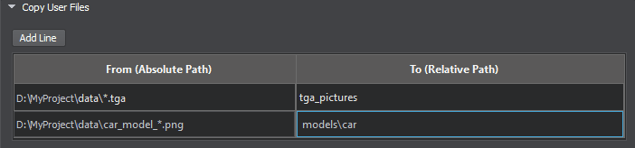

  • Files added by user用户添加的文件

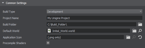

Common Settings
常用设定#
Build Type
(config)
Type of the build that defines which binaries are copied:

Project Name
(name)
Name of the output executable or .bat/.sh file. This name shall also be displayed as the Launcher's title and a title of the application window as well.输出可执行文件或.bat / .sh文件的名称。此名称也应显示为启动器的标题和应用程序窗口的标题。
Build Folder
(path)
Path to the output folder where the build is going to be stored

Default World
(world)
The world that is loaded when the application is started. If no world is selected, the User shall be responsible for loading worlds via code, otherwise, a black screen will be displayed when running the application.启动应用程序时加载的世界。如果未选择任何世界,则用户应负责通过代码加载世界,否则,在运行应用程序时将显示黑屏。
Precompile Shaders
(precompile)
If enabled, generates shaders for the current Video API.
Shader cache increases performance and reduces spikes and freezes in the release application, which makes it very important for the release build. If the shaders have already been precompiled, selecting this box won't affect the build time.
You may require forced shader compilation in specific cases.This option is always enabled for Release builds.
如果启用,则为当前的Video API生成着色器。
着色器缓存可提高性能,减少发布应用程序中的峰值和冻结,这对于发布版本非常重要。 如果着色器已经预先编译,则选择此框不会影响构建时间。

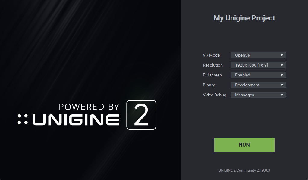

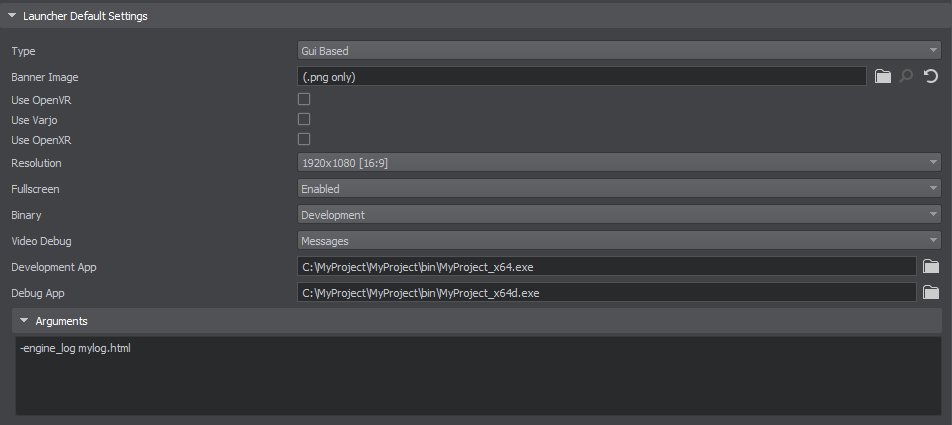

Launcher Default Settings
启动器默认设置#
These settings are used as default (pre-selected) launcher settings. The launcher for the Development build displays more settings than for the Release build.这些设置用作默认(预选)启动器设置。 Development构建的启动器显示的设置比Release构建的启动器显示的设置更多。
GUI-based launcher for the Development BuildDevelopment Build的基于GUI的启动器
Below are the settings used by the tool to generate a launcher for your application.以下是该工具用于为您的应用程序生成启动器的设置。

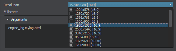

Resolution
(selected_res)
The resolution of the application screen. Multiple resolutions can be selected. The resolution that is clicked upon is set as default.
Multiple resolutions for the console mode are specified in the configuration file via the resolutions parameter (list the ones you need):

应用程序屏幕的分辨率。可以选择多种分辨率。单击的分辨率设置为默认值。

Arguments
(args)
Additional start-up command-line options.其他启动命令行选项
UnigineEditor creates the <project_name>.lconfig file that Launcher uses to run the app. If a user changes any parameters and runs the app, the changes are saved in <project_name>.lconfig. Closing Launcher without running it discards any changes.UnigineEditor创建Launcher用于运行应用程序的<project_name>.lconfig文件。如果用户更改任何参数并运行应用程序,则更改将保存在<project_name>.lconfig中。在不运行启动器的情况下关闭它会丢弃所有更改。

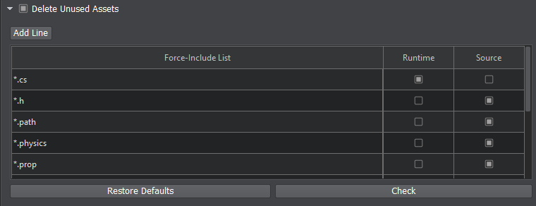

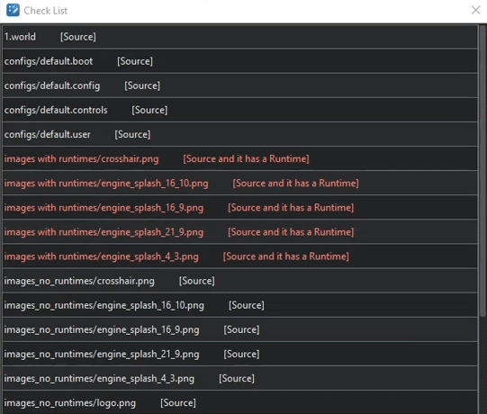

Delete Unused Assets
删除未使用的资源#
This feature enables you to delete all unused assets from the final build. To turn it on, check the option near the Delete Unused Assets section heading.
本部分使您可以指定要包含在最终版本中的资源。外观如下:
The Build tool scans all assets of the types specified as wildcards (including location) in the Force-Include list (*.world, *.cs, *.fbx, *.prop, etc.), automatically resolving all dependencies (an FBX asset shall be checked for all meshes, meshes shall be checked for materials assigned to their surfaces and so on...). Thus, all assets in your project that are used by the assets of the specified types are collected and included in the final build.Build Tool工具扫描Force-Include列表中指定为通配符(包括位置)的所有类型的资源(*.world, *.cs, *.fbx, *.prop等),自动解决所有依赖性(FBX资源应 检查所有网格,检查网格中分配给其表面的材质,等等...)。 因此,将收集项目中指定类型的资源所使用的所有资源,并将其包括在最终版本中。
You can add more asset types to the list or remove existing ones by simply right-clicking on the desired line (a new line shall be inserted after the one you clicked on). You can also click Restore Defaults to reset the list to its initial state.您可以在列表中添加更多资源类型,或通过右键单击所需的行来删除现有的资源类型(在您单击的行之后应插入新行)。您也可以单击Restore Defaults将列表重置为其初始状态。
For each type of assets in the list you can specify whether to include runtime or source file. But be careful, as checking only Runtime for .png textures will result in ignoring the ones with the Unchanged option enabled (i.e. having no runtime), they simply won't be included. To check your list against such cases click Check, the following Check List window will open:对于列表中的每种资源类型,您可以指定是包含runtime还是source文件。但请注意,由于仅检查Runtime中的.png纹理会导致忽略启用Unchanged选项(即没有运行时文件)的纹理,因此根本不会包括它们。要检查这种情况下的列表,请单击Check,将打开以下Check List窗口:
In this window all files found in the process of scanning are listed. The ones in white are ok, but the ones in red require your attention, for example, you may mistakenly choose to include source for an asset that has a runtime. So, be sure to look through red ones. The following options are possible:在此窗口中列出了在扫描过程中找到的所有文件。白色的可以,但是红色的需要引起您的注意,例如,您可能错误地选择为具有运行时文件的资源包括源。所以,一定要检查红色突出显示的文件。以下选项是可能的:
  • [Source and Runtime] - both boxes are checked (both source and runtime files shall be added).[Source and Runtime]-选中两个框(应同时添加sourceruntime文件)。
  • [Source] - when Source is checked and the asset has no runtime (only the source shall be added).[Source]-选中Use Source并且资源没有运行时文件(仅应添加source)。
  • [Source and it has a Runtime] (shown in red) - when Source is checked, but the asset has a runtime (only the source shall be added).[Source and it has a Runtime](以红色显示)-选中Use Source,但资源具有运行时文件(仅应添加source)。
  • [Runtime] - when Runtime is checked, and the asset has a runtime (only the runtime shall be added).[Runtime]-选中Use Runtime且资源具有运行时文件(仅应添加runtime)。
  • [No Runtime] (shown in red) - when Runtime is checked, but the asset has no runtime (nothing shall be added).[No Runtime](以红色显示)-选中Use Runtime,但资源没有运行时文件(应添加)。
Force-Include List for the console mode is specified in the configuration file as a set of wildcards as follows:
源代码
"delete_unused": true,
"wildcards": [
		"pattern": ".cs",
		"primary": true,
		"source": false
控制台模式Force-Include List在配置文件中指定为一组通配符,如下所示:
源代码
"delete_unused": [
        "pattern": "",
        "source": "",
        "primary": ""
Copy User Files
复制用户文件#
User files are added to the build folder by filling in the table with two columns:通过在表中填充两列将用户文件添加到构建文件夹:
  • From (Absolute Path) — an absolute path to a source file or folder. Folders can be specified using wildcards.From (Absolute Path) —源文件或文件夹的绝对路径。可以使用通配符指定文件夹。
  • To (Relative Path) — path to the destination folder that is relative of the Build Folder. It can be a folder name where the file or files are copied to, or a folder and a file name, i.e. the copied file can be renamed as well.To (Relative Path) —相对于Build Folder的目标文件夹的路径。它可以是一个或多个文件要复制到的文件夹名称,也可以是文件夹和文件名,即复制的文件也可以重命名。
There are some rules for adding user files to the build folder:将用户文件添加到构建文件夹有一些规则:
From (Absolute Path) To (Relative Path) 评论
C:\test\<folder_name> <another_folder_name>, or
\<another_folder_name>, or
\<another_folder_name>\
All files and folders inside <folder_name> will be recursively copied. Thus, it doesn't matter if you use slashes or not.<folder_name>内部的所有文件和文件夹将被递归复制。因此,是否使用斜杠都没有关系。
C:\Pictures\screenshot_alb.png \folder_with_pictures\, or
One file with the name indicated in the From column will be copied into <output_folder>\folder_with_pictures\发件人列中指定名称的一个文件将被复制到<output_folder>\folder_with_pictures\
C:\Pictures\screenshot_alb.png \folder_with_pictures\123.png
But: 123.jpg (or 123.png)
The file will be renamed.
However, if the target file extension is written incorrectly (differs from the actual file extension), a new folder with such name will be created instead, i.e. the resulting path of the example destination files will be:
该文件将被重命名。
但是,如果目标文件扩展名写得不正确(与实际文件扩展名不同),则会创建一个具有该名称的新文件夹,即该文件的结果路径。目标文件示例为:
User files for the console mode are specified in the configuration file as follows:
源代码
"rules": [
        "from": "",
        "to": ""
控制台模式的用户文件在配置文件中指定如下:
源代码
"rules": [
        "from": "",
        "to": ""

Wildcards can also be used to define the rules for copying user files.通配符也可以用于定义复制用户文件的规则。
C:\test\<folder_name>\*.tga <tga_pictures> All files with the indicated extension from the selected folder will be copied to the specified folder.所选文件夹中具有指定扩展名的所有文件将被复制到指定文件夹。
C:\test\<folder_name>\ab*z.png <another_folder_name> All files with the name starting from ab and ending with z.png from the selected folder will be copied to the specified folder.所选文件夹中所有名称以ab开头并以z.png结尾的文件都将被复制到指定的文件夹中。
C:\test\<folder_name>\nn* <another_folder_name> All files with the name starting from nn from the selected folder will be copied to the specified folder.所选文件夹中所有名称从nn开始的文件都将被复制到指定的文件夹。
C:\*.ung ///\\\/one\\\\\\////two\\/// Slashes work differently for Windows and Linux.
