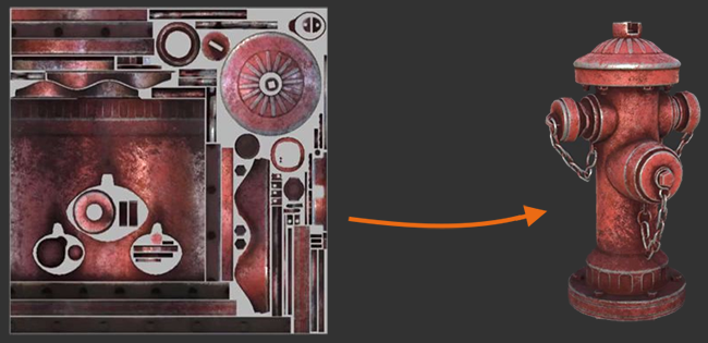

  • Textures (*.png, *.tga, *.hdri). These are images that are typically used in materials. When a material is assigned to a surface, textures are either projected onto it directly (albedo) or used as masks (for example, to define transparent areas), in addition pixel values of a texture can be used for other calculations. Textures can also be used, for example, to simulate the environment (cube maps that are projected onto the cube walls from the inside) or as light filters on projected light sources. Textures are usually created using a third-party image editing application such as GIMP or Photoshop and then imported through Asset Browser. Some textures, such as rendering textures, are generated by the UNIGINE engine. Usually certain data are taken from the scene and converted into a texture to be used elsewhere.
