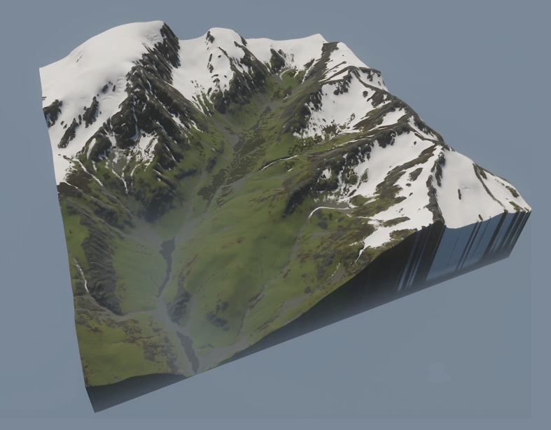

For this purpose we'll use terrain — a special type of geometry object designed for creating landscapes. The main object for working with landscape in UNIGINE is Landscape Terrain. It is optimized for vast areas and uses the material with specific texture blending to realistically simulate natural and artificial surfaces: soil, rocks, asphalt, paving stones, etc. Typically, it serves as the foundational element for open-world games, providing a basis for static geometry placement and character movement.
The Landscape Terrain system is represented by two types of nodes:
- Object Landscape Terrain — a virtual object ensuring the terrain rendering.
- One or several Landscape Layer Map objects — layers with the terrain graphic data. The layer system allows you to combine and mix layer data in different order, as well as to place high-detailed layers of small size over large low-detailed layers (the so-called inset).

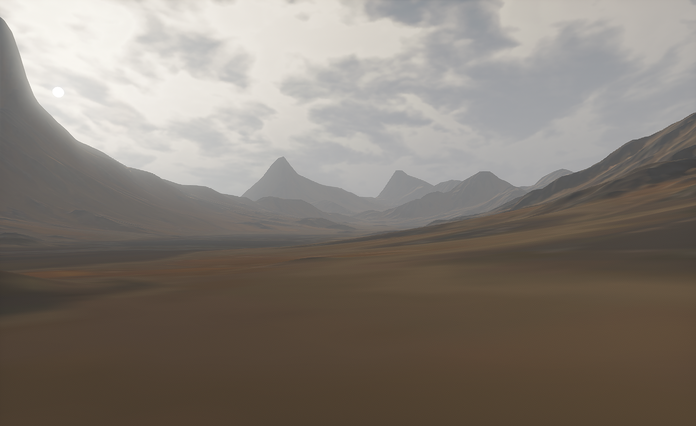

No matter how large the textures used for the surface are, the data density still won't be enough for a terrain 5 kilometers on a side. The data density is too low when viewed from the surface.
One solution is to split the original high-resolution textures into a set of tiles and use them for creating a terrain. However, even with a total resolution of 65536×65536 pixels (8×8 tiles with the size of 8192×8192 each), the density of the texels will barely exceed 13 pixels per meter. This is also not enough.
For high detailing of the surface we use terrain details — additional materials that can be mixed based on the terrain masks: the grass mask defines where the detailed grass texture will be located, the same is done for rocks, soil, sandstone, etc.
Select the ObjectLandscapeTerrain node and go to the Details parameter section. You can add as many details as you want for each mask:
After selecting a mask, click "+" on the panel to add a detail layer.
- Then click "+" on the detail material panel to add a new editable material.
- In the race/terrain/details/textures folder there is a set of textures to recreate different natural surfaces. Use the Albedo, Roughness and Height textures to make each masked area look unique.
Pay specific attention to the following parameters:
- Size — the size of one tile of the detail. Higher values increase the layer size.
- Scale — the intensity of the height displacement. Higher Scale values make the geometry irregularities more protruding.
Customizing details is a completely artistic task. Usually at least one detail layer needs to be assigned to each mask in order to cover the entire terrain surface. Detail layers, as well as masks, can be swapped if a different order of layers is required.
For convenience, the project already contains ready-made materials for the details (race/terrain/details) that are to be assigned to the detail layers in the corresponding masks.
After customizing the details, the data density is much higher and the terrain looks more natural.
