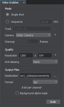

To open Video Grabber, select the appropriate item from the Editor menu:
The Video Grabber window will open:
The settings available in it allow you to select:
To capture a screenshot, we'll require the Single shot mode. The sequence of actions to create a screenshot is as follows:
- Set the desired camera view.
- Select the required camera from the list: the standard viewport camera (Engine Camera) or any other camera available in the scene (the "*" button will refresh the list).
- Specify the required resolution (to use the current viewport size, press the "*" button).
- Select antialiasing mode (supersampling multiplier) to improve image quality and remove the jagged effect on diagonal edges.
- Specify the target folder and select the desired output format (for example, JPG will provide the best compression and EXR supports 16-bpc color depth).
- Now all you need to do to get a screenshot is to click Grab.
- If you don't want to see any auxiliary visualizations in the final image, disable Visualizer (Helpers → Visualizer Mode → Disabled).
- If you need a specific screen resolution, regardless of your current monitor resolution, simply enable virtual resolution and specify the required screen size (Settings → Render → Screen → Virtual Resolution).
- If you need a transparent background, enable the Background Alpha Mask option (unavailable for JPG format).
