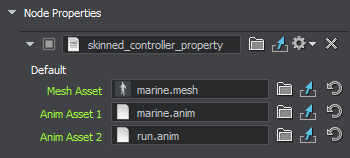

  1. Create a component for controlling loading of animations and generate a property for it.
  2. Assign its property to the target controller node.
  3. Assign desired animation assets to the parameters of the property by using the Editor.
    Assigning animation assets to property parameters via the Editor
  4. Implement logic of creating a skinned mesh with the specified animations. The complete source code:

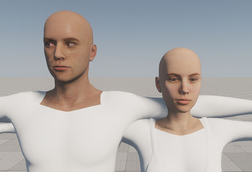

Animation Frame Masks#
Masks are the simplest way of reusing animations, a couple of words about how they work. To each layer of an ObjectMeshSkinned you can assign some animation and based on its frames it will change bone transformations on this layer. You can use masks to choose which components of the animation frame (position, rotation, scale, their combinations, or all of them) are to be used for each particular layer. In case any component is missing in the mask, the corresponding value will be taken from the T-pose.
As an example let's take eyes animation for these two skeletons:
They have absolutely the same bone hierarchy as well as bone names, only the proportions differ. If we use animation for eyes from the left skeleton for the right one, we'll get the following result:
The initial animation has completely changed the proportions of the second skeleton. We can fix it by setting ANIM_FRAME_USES_ROTATION mask to eye bones, and ANIM_FRAME_USES_NONE for the rest of the bones via the setLayerBoneFrameUses() / getLayerBoneFrameUses() methods. Thus, all values except for eyes rotation will be taken from the T-pose :
If the skeletons have different bone names you should first apply retargeting and then use masks. In this case it is not that important to have similar skeletons.

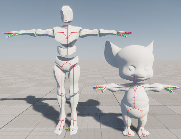

Retargeting#
To reuse animation entirely, both source and target skeletons must have similar bone hierarchy and their T-poses must not significantly differ.
This is acceptable and will work fine:
as we have similar bone hierarchies and all bones have similar bases in T-poses, only the proportions differ, but this proportion is almost uniform for all bones.

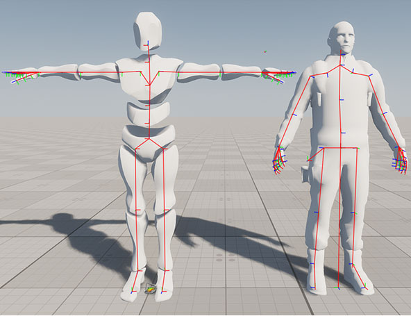

But we cannot use the following:
Although the hierarchy looks similar, the T-poses differ and bones have different bases.
These limitations can be ignored if you need to retarget only some subset of the bones (e.g.: retarget bones having different names and then use only masks).

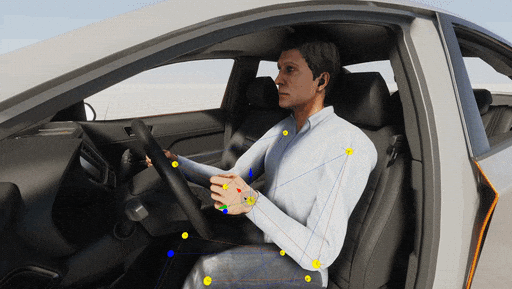

Inverse Kinematics (IK)#
ObjectMeshSkinned supports inverse kinematics (IK) for bone chains (IK chains). Inverse kinematics provide a way to handle joint rotation from the location of an end-effector rather than via direct joint rotation. You provide a location of the effector and the IK Solver attempts to find a rotation so that the final joint coincides with that location as best it can. This can be used to position a character's feet properly on uneven ground, and ensure believable interactions with the world. The tolerance value sets a threshold where the target is considered to have reached its destination position, and when the IK Solver stops iterating.
An IK chain can have an arbitrary length (contain an arbitrary number of bones), it has an auxiliary vector enabling you to control bending direction. You can also set rotation for the last joint of the chain.
Each IK chain has a weight value that can be used to control the impact of the target on the last joint of the chain. This enables you to make smooth transitions from the source animation to required target position of the limb.
To visualize IK chains you can use the following methods: addVisualizeIKChain(), removeVisualizeIKChain(), and clearVisualizeIKChain().
