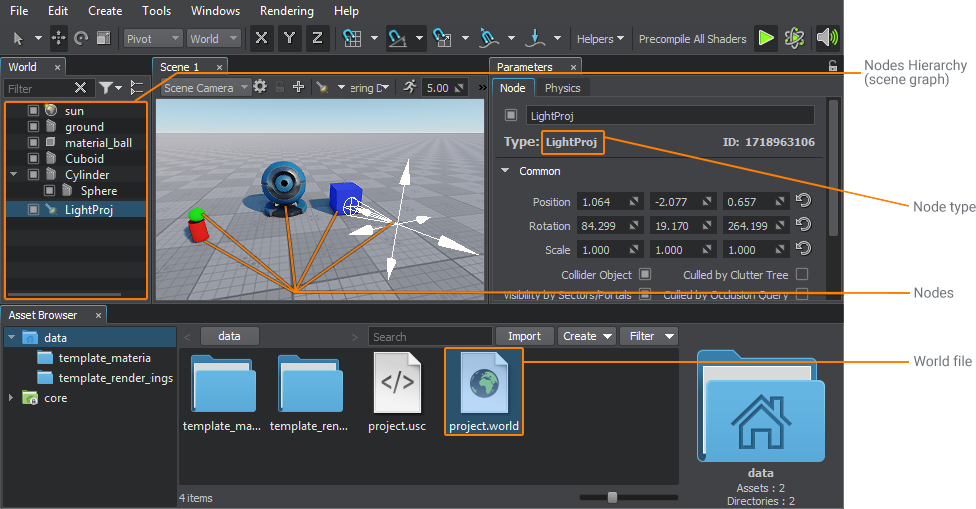

A UNIGINE-based virtual world is a 3D scene that contains a set of different scene graph nodes (e.g. static meshes, lights, cameras, etc.) placed into specified positions, and global settings (rendering, physics, etc.) applied to the whole scene.
In terms of UNIGINE, all objects added to the scene are called nodes. Nodes can be of different types, determining their visual representation and behavior. All nodes are arranged into a hierarchy: there are parent and child nodes; one node can have several child nodes. A scene graph in UNIGINE is a multi-root tree (hierarchy) of nodes. Each world is represented by an XML file with the *.world extension.
To edit your existing worlds and create new ones, use UnigineEditor. You can create and use as many worlds as you need.
There is a rich set of built-in node types with various functions. Though the set covers almost all of required cases, it can be manually extended by the user. You can also extend basic functionality of any node by adding components to it.

Parameters of all nodes in the world are usually stored in a file with the *.world extension, but can also be stored in separate XML files with the *.node extension. These files can be referenced from the *.world file via Node Reference — a specific node designed for various purposes (object templates, dividing the world hierarchy into segments).
