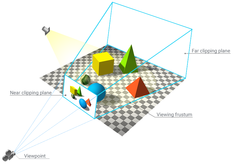

To see the virtual environment, we require virtual "eyes" — cameras. Cameras actually define what will be visible in the final image, the angle and distance from which it will be viewed. Virtual cameras come with a number of parameters, including the angle of view (FOV), near and far clipping planes, and the camera position and orientation. By combining the clipping planes with the camera's view angle, a visibility pyramid (or frustum) is created, and only objects within this pyramid are rendered as they are within the field of view. Objects outside this pyramid are not rendered as they are out of sight.

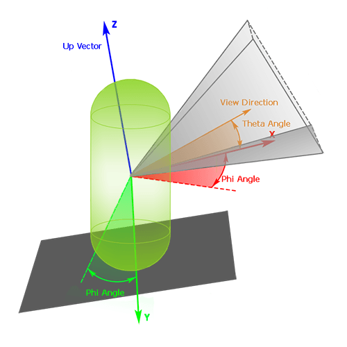

Player Actor is a player with a physical body (having mass, etc.) approximated by a capsule that can only walk on the ground (it can be used in shooters, for example).

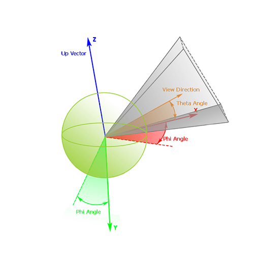

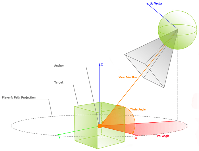

Player Persecutor is a free flying camera without a physical body that follows the target node at a specified distance (can be used, for example, for a third-person view in racing). It can collide with other objects, but cannot push or interact with them.
Player Spectator is a free flying camera without a physical body used to create a spectator mode. It can collide with objects but cannot push or interact with them.
