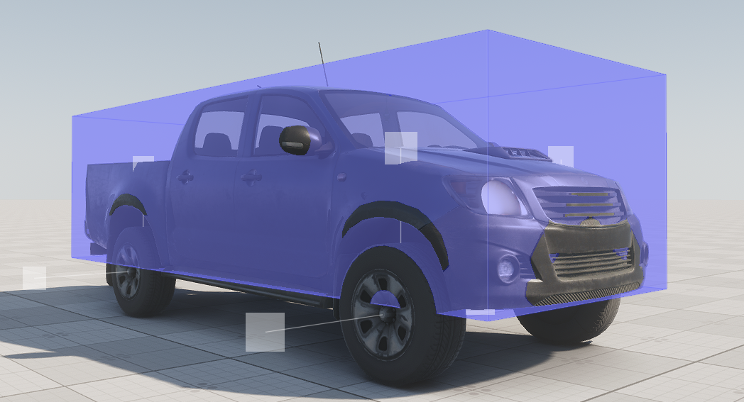

- In the pickup_frame node parameters, the Physics tab, select the Rigid physical body. Keep the default values in all its settings.
Let's also add a collision shape in the Shapes section and use the simplest and most stable shape: Box shape. Select the Box option from the list and click Add. Click Edit Size to customize the collision shape dimensions and roughly replicate the body shape: the simpler the physical representation, the better it is for calculations.
Let's set the following collision shape parameters:
- Friction coefficient: 1.0
- Restitution coefficient: 0.0
- Car body Mass: 60 kg
NoticeThe real car body weight is about 2000 kilograms, but for a physical game engine the real mass is not always the best option. The model must simulate the real object's behavior while remaining optimal for real-time computations. Therefore, configuring the physical model is all about selecting coefficients to ensure that the model behaves as naturally as possible. -

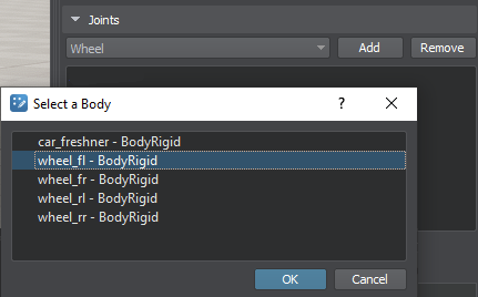

Select the car body pickup_frame node and add four Wheel joints in the Joints section selecting the wheels one by one.

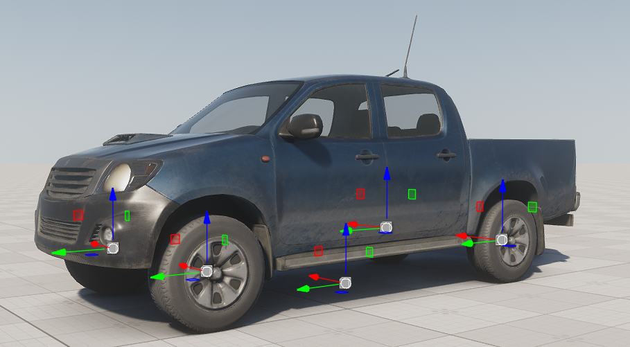

- Select joints one by one and click the Fix 0 button for each of them, to move the joint connection point to the center of each wheel. Now each wheel is connected to the car body and will continuously tend to the specified center.
Select all joints using the Shift button and set the following parameter values:
- Iterations (number of calculation iterations per joint): 2
- Linear/Angular Restitution coefficients: 0.2
- Linear Damping coefficient: 300
- Linear From and Linear To (shock absorber operating range): 0.1 meter. You can increase these values to make suspension more active, but the whole system may become unstable on uneven surfaces and at high speeds.
- Linear Spring (shock absorber force): 500
- Tangent/Binormal Friction (longitudinal and transverse friction coefficients for tires): 4.0 and 1.0. You can try different values and adjust the grip between the tires and the ground.
- Wheel Mass: 10 kg
- Wheel Radius: 0.37 m for the provided model. If you use your own 3D model, set the wheel radius value corresponding to your model wheels.

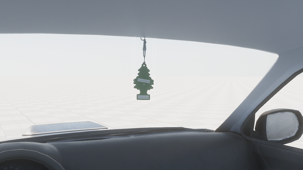

Fine-Tuning Air Freshener (optional)#
Adding dynamic details like this can add to the car driving experience.
- Select the car_freshner node and assign the Rigid body to it in the Physics tab.
- Add the Box collision shape.
- Select the pickup_frame node and add the Ball joint in the Joints section. Press the Fix 0 button in its settings to shift the joint center to the current position of the freshener node.
Configure its parameters as follows:
- Damping coefficient: 1.0
- Physical bodies connected with a joint won't collide if the Collision option is disabled, let's keep it as it is.
- Angle (maximum possible swing angle from the initial position): 155
Now the air freshener will move actively depending on the loads experienced by the vehicle.
