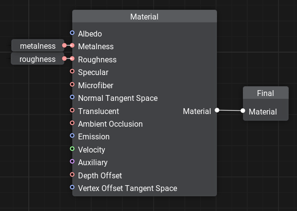

The Material node is the main node of your material. It provides a set of input graph data and generates a material of a certain type depending on the current settings.
For example, for PBR materials we can control Albedo, Metalness, Roughness, Specular, Microfiber, and Normal values that define the surface properties.
The Material node output is connected with the Final node, which is the main node of the output material.
A material graph can contain several Material nodes, but only the one connected to the Final node will be used.

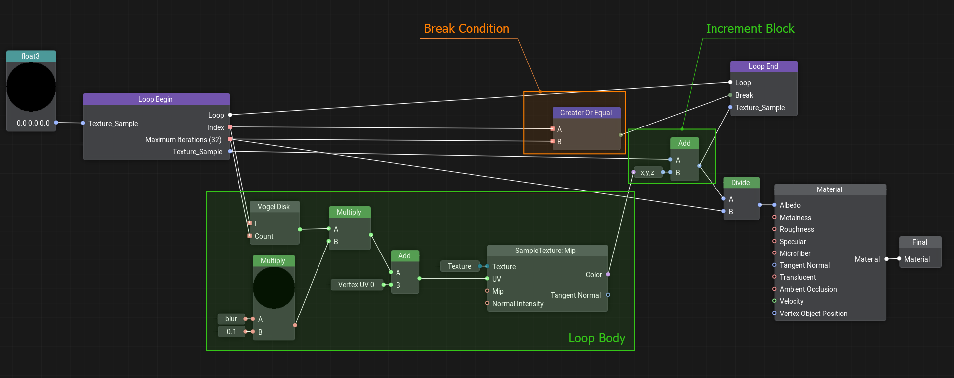

Loops#
When you need to perform a certain action several times, cloning the corresponding group of nodes will quickly make your graph overcomplicated, even if only 10 iterations are required. In UNIGINE, you can create loops for this purpose, just like in programming.
To create a loop, simply add the Loop Begin and Loop End nodes and connect their Loop ports.
Double-click on the Loop Begin node to open the loop constructor window and set the variables that change with each iteration of the loop and the total number of iterations. See the documentation for details on creating loops.

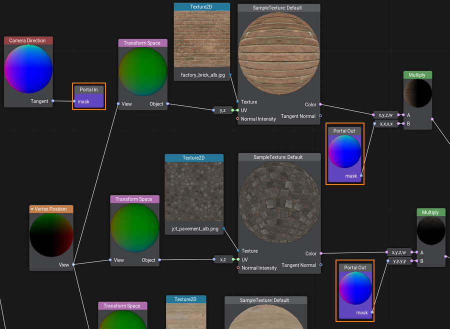

Portals#
A portal is a set of special nodes that has one input (Portal In) and one or more outputs (Portal Out) all having the same name. Portals serve to reduce the number of intersecting edges and make the graph more 'readable'.

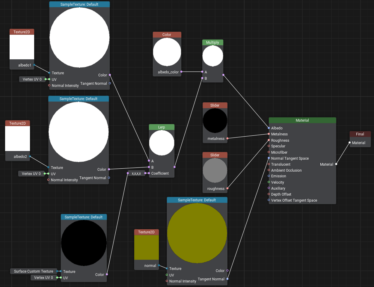

Creating a Material in Material Editor#
Let's create a wall material with the ability to blend two albedo textures by mask. This material can be used to simulate a multi-layered material where some layers show through others, such as an old or stylized plastered wall with brickwork visible in areas where plaster has fallen off. Our new material will have two albedo textures, we will blend them using Custom Surface Texture as a single channel mask, which will determine how clearly the second texture shows up on the first (in areas where the mask has black color the albedo1 texture will be painted, and albedo2 in white areas).
  1. Let's create a new material graph by right-clicking in the Asset Browser and selecting Create Material → Material Graph:
    and name it albedo_mixer.
  2. Open the Material Editor by double-clicking on the created *.mgraph asset.
  3. In the list of parameters, find the albedo texture and rename it to albedo1.
  4. Add the second albedo texture to parameters, so that either of them could be assigned. To do this, click + in the Parameters section, then in the dialog box for Type choose Texture2D, in Name enter the name of the new texture – albedo2, and click Ok.
  5. To use the new parameter in the graph as a node just drag it to the working space.
  6. Drag the Texture2D node output, type Sample Texture in the constructor panel and press Enter.
  7. Drag the UV input of the Sample Texture node, type in Vertex UV0 and select the corresponding node from the list.
  8. Add the Lerp node that will perform linear interpolation between the colors of the albedo1 and albedo2 textures with a coefficient from the mask. Connect the Color output of the Sample Texture node taking the value from albedo1 to input A, and the Color output from the Sample Texture node connected to albedo2 — to input B.
  9. And the last item to be added is the interporation coefficient. Create the Surface Custom Texture node and add the Sample Texture node for it (as we already did by connecting Vertex UV0 to the UV input). Drag the Color output from this node to the Coefficient input of the Lerp node and select the X,X,X,X adapter because we need only the first channel.
  10. The resulting graph should look as follows.
  11. Save it by clicking the Save button and close the Material Editor.
  12. Now let's assign this material to the wall by dragging it directly from the Asset Browser and inherit a user material from it by clicking Create a child material in order to assign your own textures.
  13. Download and drag the following images to the Asset Browser, after importing drag wall_brick.jpg and wall_plaster.jpg to the Albedo1 and Albedo2 fields accordingly.
