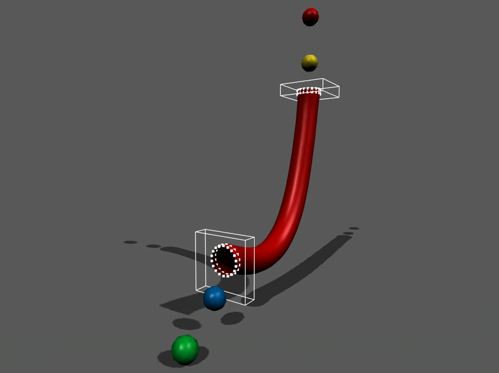

Water Body#
It enables the physical simulation of liquids of different densities and viscosities. It also allows creation of the buoyancy effect and wave dynamics.
A Water body can be assigned only to Water Meshes and Dynamic Meshes.
A mesh to which the Water body is assigned should meet several requirements:
  • The mesh should be flat and have a uniform grid.
  • The mesh should be oriented strictly along the axes.
  • The mesh should have the UV map.

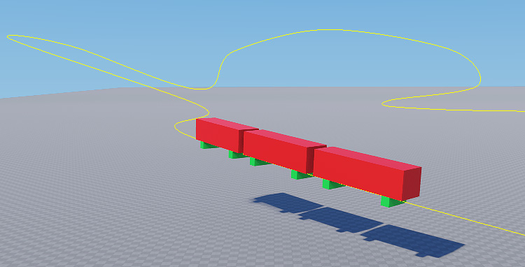

Path Body#
It is also a type of body without physical properties: it represents a spline along which an arbitrary rigid body can move. It can be used, for example, to create a physically simulated train moving along a rail track.
A Path body which is used as a railway track for a train
To connect a Rigid body to a Path body, use a Path joint.

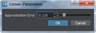

Convex Hull#
A convex hull is the slowest of all shapes. Usually, it is used for objects with complex geometry. This shape is the smallest one that can enclose vertices of the approximated mesh. At that, it includes holes and cavities of the mesh in the shape volume.
To generate a convex hull, specify the Approximation Error value that allows reducing the number of vertices of the created shape. Note that simple and rough convex hulls with a small number of vertices are processed faster, so we recommend keeping the number of vertices as low as possible.
The higher the error value, the fewer vertices in the generated shape, but the more mesh details are skipped.

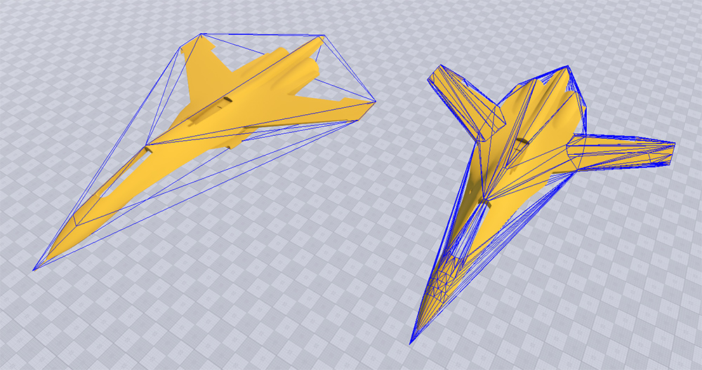

An autogenerated shape is a set of convex hulls that can approximate a complex concave object and exclude cavities from its volume.
In the picture below, you can see a complex concave object. On the left, it's approximated with a single convex hull. And on the right — with an autogenerated set of convex hulls.
When generating this type of shape, you should specify the following beside the Approximation Error value:
  • Recursion Depth that sets the degree of mesh decomposition.
  • Merging Threshold that determines the volume threshold for merging convex shapes after decomposition.
The values you specify affect how many shapes are generated and how well they fit the object.

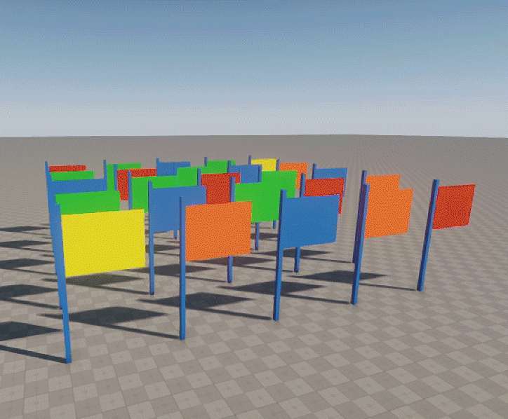

Physical Wind is a cuboid-shaped object simulating wind blowing within its volume.
The wind only affects objects placed inside the Physical Wind box and having physical bodies assigned.
The Physical Wind can affect only the Cloth and Rigid bodies. At that, the Rigid body must have a collision shape assigned.
The wind differently affects objects with different physical properties. So, besides changing the Physical Wind parameters, you should adjust the parameters of the physical body.
For example, if you place an object with the Cloth body inside the Physical Wind volume, the way it "waves in the wind" will vary depending on the Cloth body mass, rigidity, and other parameters.
When you set up the wind, you can change the size of the volume in which the wind blows, specify the wind velocity, attenuation threshold, and damping of the linear and angular velocities of the objects when they get inside the wind volume.
You can also choose which physical bodies are affected by the wind. For example, you can make only one flag flutter in the wind while the others stay still. For this purpose, there is the Physical mask — it must match the Physical mask of the physical body affected by the wind.

The Physical Noise is a cuboid-shaped area that adds a distribution flow based on a volumetric noise texture. This effect simulates a force field that affects particles and physical bodies.
  • Physical Noise affects only the Cloth, Rope, and Rigid bodies. At that, the Rigid body must have a collision shape assigned.
  • Physical Noise will affect particles only if their physical mass is non-zero. You can set this in the settings of the Particles object.
The direction of the force affecting particles and physical bodies within the Physical Noise volume is stored in the Noise texture — a 3D texture, where each texel stores the force direction.
To be sure that the force at the current point affects the physical body entering the Physical Noise volume according to the Noise texture, you need to provide the texture generation and sampling parameters for the Noise texture, along with the Force multiplier.
