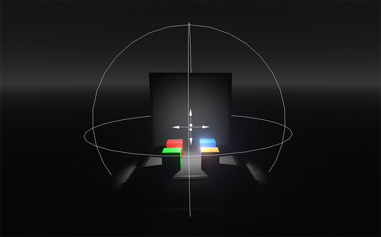

Omni Light#
Omni Light is a point source emitting light in all directions and realistically reproducing cast shadows. This type of light serves to simulate light sources with bright center and equal roll-off of intensity. Omni Light proves useful for general lighting purposes in indoor scenes because of its nondirectional qualities. In addition, Omni Light has many shapes and therefore can be used to create a variety of lights for indoor and outdoor lighting.
