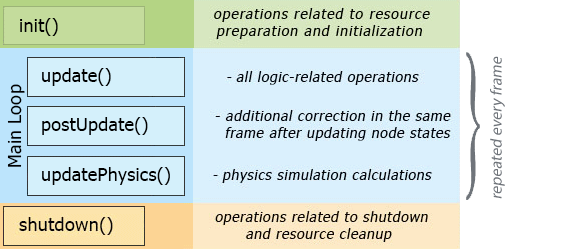

Every UNIGINE-based application has its life cycle, that consists of certain stages, some of them are performed once, others are repeated each frame. In short, these stages are as follows:
UNIGINE has three main logic components, each of them has a set of functions (named Init(), Update(), Render(), etc.) that contain actions to be performed at corresponding stages of the Engine's working cycle. These components are:

Logic#
The component logic is implemented using a set of methods that are called by the corresponding World Logic functions:
  • Init() — all necessary resources are created and initialized.
  • UpdateAsyncThread() — used for specifying all logic functions you want to be called every frame independently of the rendering thread.
    This function does not have protection locks, so it is not recommended to modify other components inside this function, unless you are absolutely sure, that these components won't be modified or removed elsewhere.
  • UpdateSyncThread() — used for specifying any parallel logic functions to be executed before the Update(). This method is used to perform resource-consuming calculations such as pathfinding, procedural texture generation, etc.
    This method should be used to call only those API methods that apply to the current node: the node itself, its materials and properties.
  • Update() — used for specifying all logic-related functions you want to be called every frame.
  • PostUpdate() — used to adjust the behavior according to the updated states of the nodes in the same frame.
  • UpdatePhysics() — physics simulation is performed: continuous operations (moving the car forward depending on the engine speed, simulating constant wind, performing immediate reactions to a collision, etc.).
  • Swap()— operating with the results of the updateAsyncThread() method — all other methods (threads) have already been performed and are idle. After this function, only two actions occur:
    • All objects that are queued for deletion are deleted.
    • Profiler is updated.
  • Shutdown() — cleanup is performed when the component is shutdown.
The most frequently used functions are Init() and Update().
