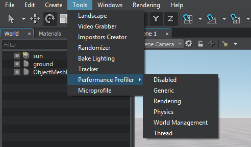

To turn on the profiler, click Tools -> Performance Profiler in the main menu of UnigineEditor and choose the required profiling mode.
Depending on the selected mode, the set of displayed data will differ:
  • Generic profiler shows the general statistics block only. It includes such indicators as total time taken to calculate and render the current frame, time spent on updating the application logic, GPU waiting time, CPU rendering time, GUI rendering time, physics calculations, allocated memory size, as well as the number of synchronous and asynchronous threads. This general statistics block is available in all profiling modes.
  • Rendering profiler shows the detailed rendering statistics and the timeline chart.
  • Physics profiler shows the detailed physics-related statistics (within the Physics radius) and the timeline chart.
  • World Management profiler shows the statistics on the currently loaded virtual world: total number of nodes, physical bodies, and joints, as well as time spent on procedural content creation (e.g. grass and clutters).
  • Thread profiler shows the statistics on loading threaded resources: time of asynchronous loading of resources, sounds, as well as asynchronous pathfinding calculations.

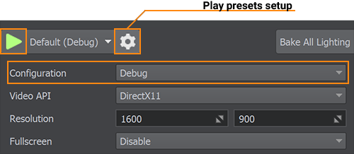

  2. Build and run the Release version of the project: open UnigineEditor, select Release in the Configuration field, and then click the Play button.
  3. Run the microprofile_enabled 1 console command, if Microprofiler hasn't been enabled via SDK Browser yet.
