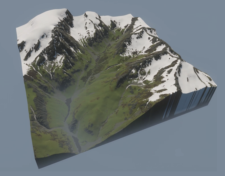

You can model a fairly simple terrain by drawing it manually using the UnigineEditor's built-in landscape editor. However, realistic natural terrains are usually created in specialized software such as: Quadspinner Gaea, World Machine, World Creator, SideFX Houdini, etc. Using these tools, you can simulate a suitable landscape and get a set of textures that define the shape and color of the terrain for the game engine.
Terrain in Quadspinner Gaea

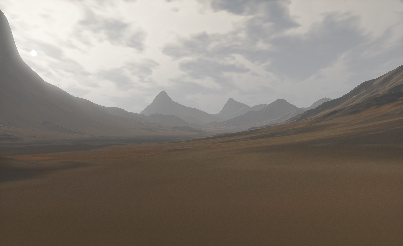

After customizing the details, the data density is much higher and the terrain looks more natural.
