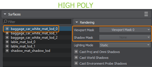

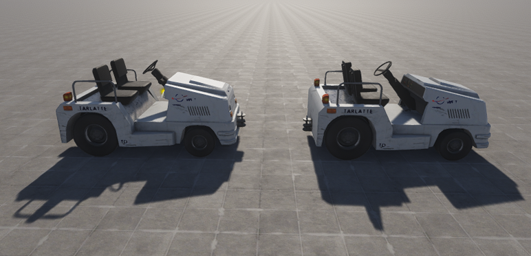

Another way to reduce perfomance load is to use simplified geometry for shadow casting:
  • Create a simplified low-poly surface of an object (or use the object's final LOD)
  • Use a Viewport Mask to hide the surface from the camera
  • Disable shadow casting for the original object via the Shadow Mask
  • Enable shadows for the low-poly version so it casts the shadow instead.
Original object casting shadows (on the left) vs. simplified shadow geometry (on the right)

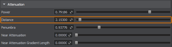

  1. Specifying visibility distances for the light sources and the cast shadows.
  2. Adjusting the beam length (attenuation distance) in the light's Parameters tab to limit the area affected by the light.

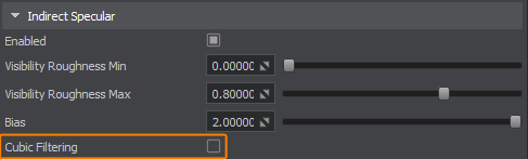

The main performance overhead in Voxel Probe comes from Cubic Filtering. Disable it if the linear filtering for ambient lighting is enough.

Just like with Voxel Probes, Cubic Filtering is the main performance drain when using Environment Probes. For better efficiency, only enable it when linear filtering isn't enough.

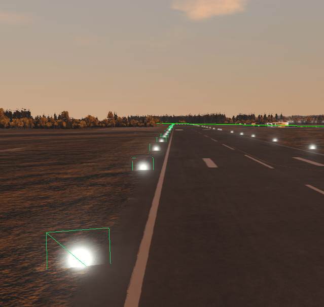

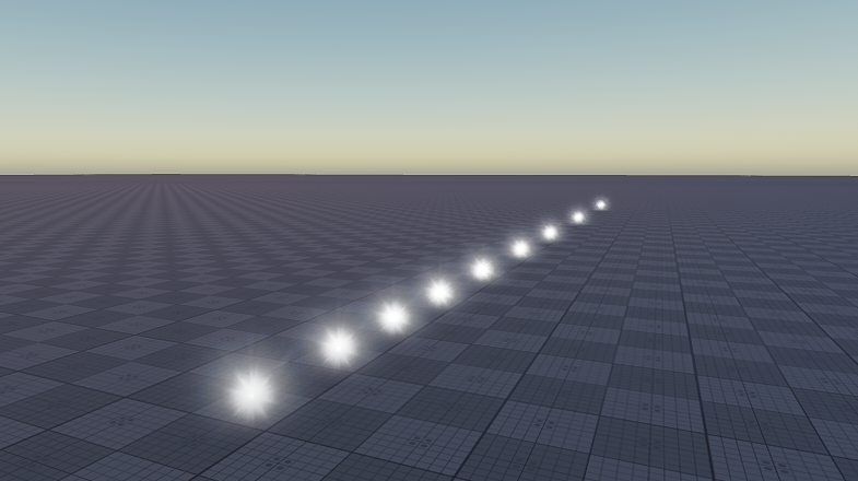

Using Billboards#
Billboards can be used to simulate small light sources observed from large distances. In such cases, only visualization of light sources matters. For example, you can use Billboards for takeoff runway lights. They don't produce any light, but look like real lights.
Billboards Used for Takeoff Runway Lights

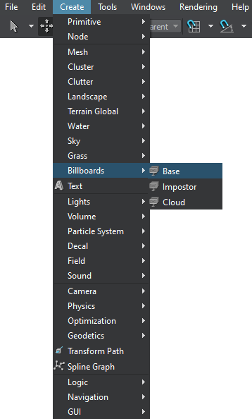

To create Billboard that replaces a real light source, perform the following:
  1. Add a Billboard object to the scene by choosing Create -> Billboards -> Base in the Menu Bar and place it somewhere in the world.
  2. Assign a material inherited from the billboards_base material.

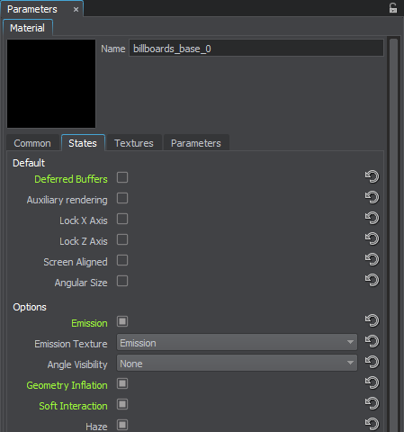

  3. Specify the following settings for this material:
    1. In the Common tab, set the blending Preset to Additive and toggle the Depth Write parameter off to avoid obstructing objects behind the Billboard.
    2. In the States tab, disable writing into the Deferred Buffers and enable the following states:
      • Emission to provide the emission effect by using the corresponding texture.
      • Geometry Inflation to limit the minimum Billboard screen size to a fixed value and, therefore, to provide visibility from far distances.
      • Soft Interaction to make interaction of the Billboard with other objects in the scene softer and avoid artifacts.
    3. In the Textures tab, specify the Diffuse and Emission textures.
    4. In the Parameters window, specify the following values:
      • Set the Diffuse color multiplier to black, so that Billboard become fully transparent.
      • Increase the Emission Scale to make Billboard brighter.
      • Increase the Geometry Parameters to scale the size of Billboard and limit the minimum size of Billboard.
      • Correct the Soft Interaction value, if necessary.
As a result, you get the Billboard that can be used to simulate a small light source at far distances. You can add any required number of Billboards to the existing Billboard object: in the Parameters window, select the created Billboard in the list and click Add.
Lights Simulated by Billboards

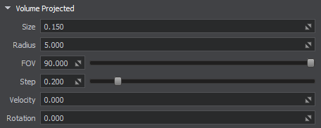

  5. Add the Volume Projected object by choosing Create -> Volume -> Projected in the Menu Bar and make it a child of the node that should emit the light.
  6. In the Node tab of the Parameters window, reset the position and rotation of the Volume Projected to the parent node ones.
  7. In the Volume Projected section of the Parameters window, specify the required parameters of the light beam. For example, change its size, radius, field of view, and step.

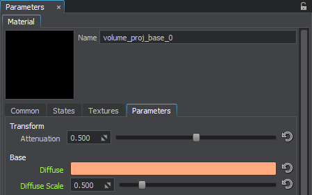

  8. Assign a material inherited from the volume_proj_base base material.
  9. In the Parameters window of the material, set the color of the light beam the same as for the Volume Sphere and decrease the diffuse scale to 0.5 to make the color less bright.
As a result, you get a light sphere and a beam imitating the real light source.
