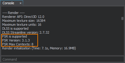

The upscalers are initialized on render initialization. To verify whether they are supported and initialized after application startup, you can do one of the following:
  • Check the Render section of the console output.
  • Run the dlss_info and/or fsr_info console commands.
For example, the Render section may provide the following information:
Source code
---- Render ----
DLSS is supported
DLSS Streamline version: 2.7.32
FSR is supported
FSR Version: 3.1.3
FSR Max Contexts: 8
FSR RAM Scratch Size: 10 MB

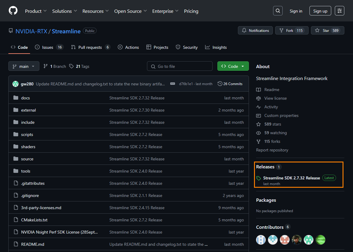

  4. Switch to the repository homepage by clicking Streamline as you did previously.

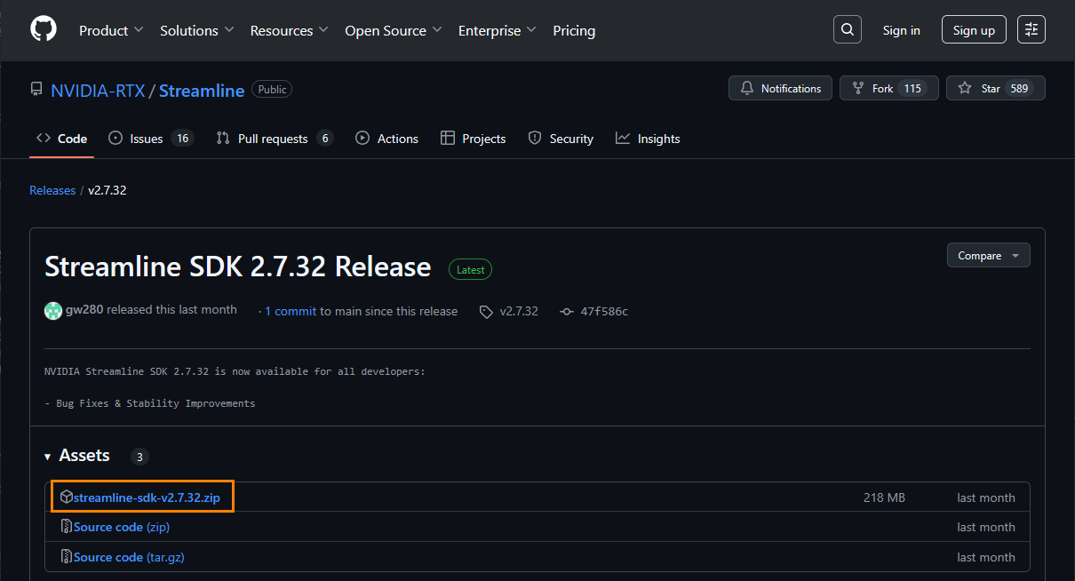

  5. Download Streamline SDK 2.7.32 Release. Click on the Releases link:
    Find Streamline SDK 2.7.32 Release and download the archive:
  6. Extract the ZIP archive. By default, it is extracted to the streamline-sdk-v2.7.32 folder. However, you can rename it if necessary.
