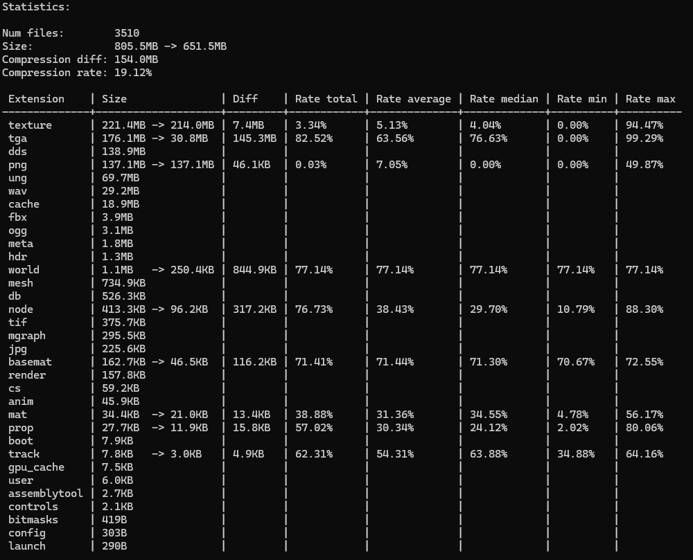

Statisctics Overview#
When you request statistics for an archive using the -s <ARCHIVE>, the output includes both general and extension-specific statistics
Result of running ung_x64 -s data.ung: all included file extensions are listed along with their sizes before and after the compression.
General Statistics:
  • Num files - Displays total number of files in archive.
  • Size - Displays the original size of the archive and the compressed size.
  • Compression diff - Indicates the amount of space saved by compression.
  • Compression rate - Displays the compression ratio as a percentage, representing how much smaller the compressed archive is compared to the original.
Per-Extension Statistics Table:
  • Extension: The file extension (e.g. texture, json, xml)
  • Size: The total size occupied by files of this extension, showing the original and compressed sizes.
  • Diff: The total amount of space saved for this extension.
  • Rate total: The overall compression rate for all files with this extension.
  • Rate average: The average compression rate across all files of this type.
  • Rate median: The median compression rate, showing the most common compression outcome.
  • Rate min: The minimum compression rate observed for this extension.
  • Rate max: The maximum compression rate observed for this extension.
