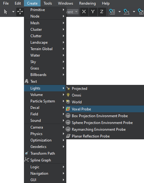

To add Voxel Probe to the scene via UnigineEditor, do the following:
  1. On the Menu bar, click Create -> Light -> Voxel Probe.
  2. Place Voxel Probe somewhere in the world.
  3. Bake Lighting or set the Texture parameter by choosing a prebaked lighting texture from assets.
