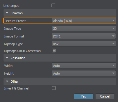

When importing textures, it is crucial to indicate their type as it determines the final format of the runtime-texture, channels to be used, and compression methods to be applied. To specify this, you can select the appropriate preset while importing a texture asset.导入纹理时,正确标明纹理类型至关重要,因为这决定了运行时纹理的最终格式、使用的通道以及应用的压缩方法。为此,你可以在导入纹理资源时选择合适的预设。
Moreover, you can add a postfix to the texture name to pre-define its type and apply the necessary import parameters automatically. Postfixes correspond to presets such as _alb for Albedo, _n for Normal, _e for Emission, and more (see documentation for a complete list).此外,你可以通过在纹理名称中添加后缀来预定义其类型,系统会自动应用对应的导入参数。常用后缀包括:_alb表示反照率,_n表示法线贴图,_e表示自发光等(完整列表请参阅文档)。
