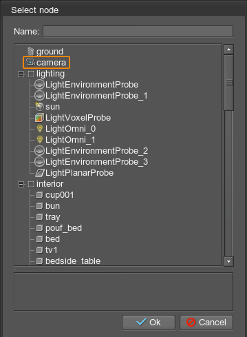

  1. Add a track that will animate the movement of our camera: Click . This will open the Add Parameter window.添加一个控制摄像机移动的轨道:点击。这将打开Add Parameter(添加参数)窗口。
  2. Select a parameter from the list, in our case it will be node → position.从列表中选择参数,本例中选择node → position
  3. Since the track animates the movement of the camera (Player) node, you must bind it to a specific node in the Select Node window that opens. Select the camera node and click Ok.由于该轨道将动画化cameraPlayer)节点的移动,你需要在弹出的Select Node(选择节点)窗口中将其绑定到特定节点。选择camera节点并点击OK
  4. The track is added, now let's do the same for the node → rotation parameter (we will change the camera rotation as well).轨道添加完成后,现在为node → rotation参数执行相同操作(我们也将改变摄像机旋转)。
  5. Now let's set the duration of our clip, click on the panel at the bottom to open the settings.接下来设置片段时长,在底部面板点击打开设置。
  6. In this window we will specify the beginning (0) and the end (12) of our clip – it will last 12 seconds. By the way, the third parameter (Unit Time) is used as a scaling multiplier, using it alone you can make the clip play faster or slower.在此窗口中指定片段的起始(0)和结束(12)时间:片段将持续12秒。顺便说明,第三个参数(Unit Time)用作时间缩放乘数,仅调整此参数即可让片段播放更快或更慢。
