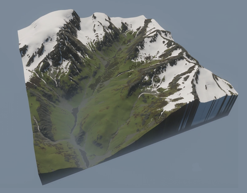

You can model a fairly simple terrain by drawing it manually using the UnigineEditor's built-in landscape editor. However, realistic natural terrains are usually created in specialized software such as: Quadspinner Gaea, World Machine, World Creator, SideFX Houdini, etc. Using these tools, you can simulate a suitable landscape and get a set of textures that define the shape and color of the terrain for the game engine.
Terrain in Quadspinner Gaea

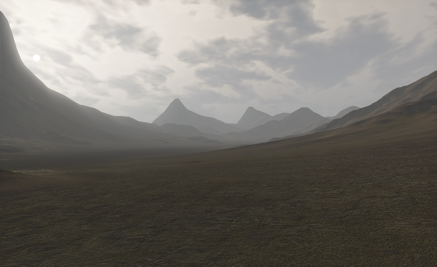

Details#
No matter how large the textures used for the surface are, the data density still won't be enough for a terrain 5 kilometers on a side. The data density is too low when viewed from the surface.
One solution is to split the original high-resolution textures into a set of tiles and use them for creating a terrain. However, even with a total resolution of 65536×65536 pixels (8×8 tiles with the size of 8192×8192 each), the density of the texels will barely exceed 13 pixels per meter. This is also not enough.

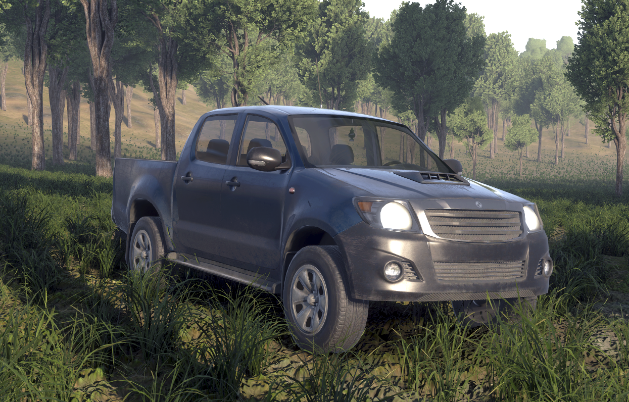

Vegetation#
To diversify the landscape, let's add vegetation. Use the ready-made tree and grass assets from the race/vegetation folder.
Adding trees:
  1. Right-click on the trees_clutter.node asset from the trees folder, select Place as Node Content in the context menu and add the asset content to the scene.
  2. In the World Nodes window, drag the trees_clutter node to ObjectLandscapeTerrain to make the trees children of the terrain, and reset the position to align the trees with the terrain (the terrain itself and the LandscapeLayerMap node are also located in the origin).
  3. Trees (the trees_clutter node) are represented by the Mesh Clutter object that arranges polygonal meshes procedurally on a rectangular area according to the the specified parameters. In addition, this node is a child of the terrain object and the Intersection option is enabled in the object settings, so the trees automatically follow the surface of the terrain.
  4. In the object settings, find the Mask Terrain parameter: use it to select the terrain mask that will be used to arrange procedural trees. It can be the Grass mask or any other mask at your choice.
  5. Rendering multipolygonal trees at a great distance from the camera can significantly impact performance. To address this, the Grass object is added as a child node to the trees to handle rendering of impostors. This object has the same settings as the Mesh Clutter object, ensuring that each tree is replaced by its "photo" when viewed from a distance. In the Mask Terrain parameter of the Grass object's settings, select the same mask in the first of the four lists (since impostors only use one type of texture out of four possible) that was selected in the previous step.
Add the contents of the grass/grass_clutter.node asset in the same way to generate grass on the terrain surface. Grass is also represented by Mesh Clutter objects (grass_close, grass_far) that procedurally arrange bunches of polygonal grass.
