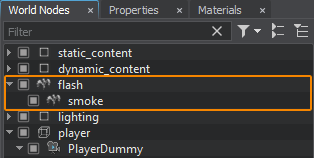

  3. To synchronize several particle systems, we need to combine them into a hierarchy (the Duration value of the parent particle system must be big enough to enclose Duration and Delay intervals of all child particle systems). So, to make smoke automatically appear when flash is activated, add smoke as a child node for flash.
  4. In our case everything is simple, each of the systems generates one particle, but we need to make the smoke appear with a slight delay and last a little longer. For this, we'll set the Delay parameter in the Emission group equal to 0.1, and Life Time — to 0.2. For Increase In Radius, set the value to 0.3.
  5. The last step is to drag the flash node from World Hierarchy to Asset Browser and rename the resulting asset to gun_fire.node. Now it is ready to be used for the fire effect (the node itself can be removed from the scene).
