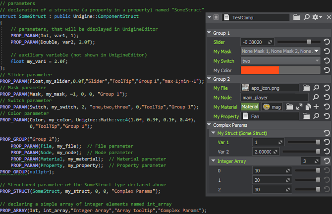

Declare parameters with their default values (if any). The simplest way to declare a parameter is to use the following macro (optional arguments are enclosed in square brackets []):声明参数及其默认值(如果有)。声明参数的最简单方法是使用以下宏(可选参数用方括号[]括起来):
源代码 (C++)PROP_PARAM(param_type, name[, default_value, title, tooltip, group]);
A set of macros enables you to define multiple types of component parameters to be displayed and adjusted in UnigineEditor. See the the ComponentBase class documentation for the detailed information about supported parameter types and attributes.通过一组宏定义,你可以在UnigineEditor中配置多种组件参数类型并进行调整。完整支持的参数类型及属性说明,请参阅ComponentBase类的官方文档。
The list of available macros includes the following ones to declare complex-type parameters (arrays, structures, and arrays of structures):以下宏可用于声明复合类型参数(数组、结构体及结构体数组):
源代码 (C++)PROP_STRUCT(type, name); PROP_ARRAY(type, name); PROP_ARRAY_STRUCT(type, name);
