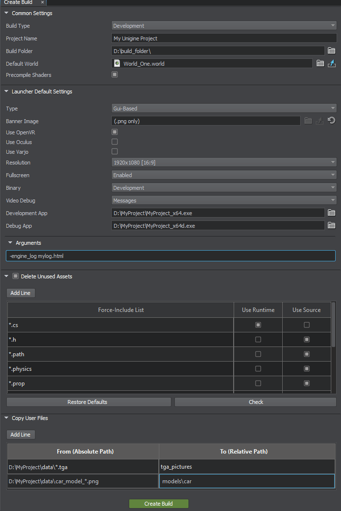

  1. In UnigineEditor, select File -> Create Build. The Create Build window will open.
    В UnigineEditor выберите File -> Create Build. Откроется окно Create Build.
  2. Specify the required settings and click Create Build.Укажите необходимые настройки и нажмите Create Build.
For building C# Component System projects, Component System should be initialized successfully.Для создания проектов с компонентной системой C #, данная система должна быть успешно инициализирована.
If a project fails to build, check the UnigineEditor console for more details.Если проект не удается собрать, проверьте консоль UnigineEditor для получения дополнительных сведений.

Build Settings
Настройки сборки#
Common Settings
Общие настройки#
Build Type
(config)
Type of the build that defines which binaries are copied:
  • Release — optimized binary without any additional debug info. Release — optimized binary without any additional debug info.
  • For the Development build, two binaries are copied:
    • development binary — optimized binary with Microprofile enableddevelopment binary — optimized binary with Microprofile enabled
    • debug binary — unoptimized binary with debug information enableddebug binary — unoptimized binary with debug information enabled
    development binary — optimized binary with Microprofile enableddebug binary — unoptimized binary with debug information enabled
If the project's SDK is unavailable, this option is unavailable, as well. In this case, Build Type is defined by the build of UNIGINE Engine selected at the project creation.If the project's SDK is unavailable, this option is unavailable, as well. In this case, Build Type is defined by the build of UNIGINE Engine selected at the project creation.
Release — optimized binary without any additional debug info. For the Development build, two binaries are copied:
development binary — optimized binary with Microprofile enableddebug binary — unoptimized binary with debug information enabledIf the project's SDK is unavailable, this option is unavailable, as well. In this case, Build Type is defined by the build of UNIGINE Engine selected at the project creation.
Тип сборки, определяющий, какие двоичные файлы копируются:
  • Release — optimized binary without any additional debug info. Release — оптимизированный двоичный файл без дополнительной отладочной информации.
    Для сборки Development копируются два двоичных файла:
    • development binary — optimized binary with Microprofile enabledдвоичный файл development — оптимизированный двоичный файл с включенным Microprofile
    • debug binary — unoptimized binary with debug information enabledдвоичный файл debug — неоптимизированный двоичный файл с включенной отладочной информацией
If the project's SDK is unavailable, this option is unavailable, as well. In this case, Build Type is defined by the build of UNIGINE Engine selected at the project creation.Если SDK проекта недоступен, этот параметр также недоступен. В этом случае Тип сборки определяется сборкой UNIGINE Engine, выбранной при создании проекта.
Project Name
(name)
Name of the output executable or .bat/.sh file. This name shall also be displayed as the Launcher's title and a title of the application window as well.Имя выходного исполняемого файла или файла .bat / .sh. Это имя также должно отображаться как заголовок файла запуска приложения и заголовок окна приложения.
Build Folder
(path)
Path to the output folder where the build is going to be stored

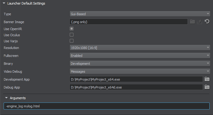

Launcher Default Settings
Параметры запуска по умолчанию#

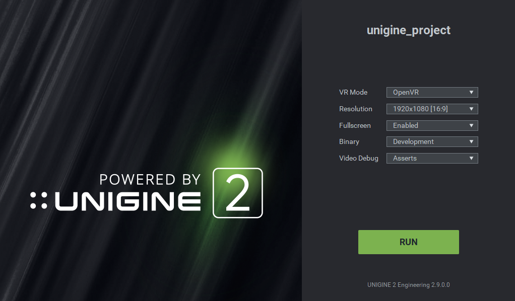

These settings are used as default (pre-selected) launcher settings. The launcher for the Development build displays more settings than for the Release build.Эти настройки используются как настройки файла запуска (Launcher) по умолчанию (предварительно выбранные). Панель запуска для сборки Development отображает больше настроек, чем для сборки Release.
GUI-based launcher for the Development BuildПрограмма запуска на основе графического интерфейса для Development Build
Below are the settings used by the tool to generate a launcher for your application.Ниже приведены настройки, используемые инструментом для создания файла для запуска вашего приложения.

Use OpenVR Check this box, if your project is intended for OpenVR. This will enable OpenVR mode selection in the application launcher.Установите этот флажок, если ваш проект предназначен для OpenVR. Это позволит выбрать режим OpenVR в средстве запуска приложений.
Use Oculus Установите этот флажок, если ваш проект предназначен для Oculus. Это позволит выбрать режим Oculus в панели запуска приложений.
Use Varjo Check this box, if your project is intended for Varjo. This will enable Varjo mode selection in the application launcher.Установите этот флажок, если ваш проект предназначен для Varjo. Это позволит выбрать режим Varjo в панели запуска приложений.
Necessary VR modes (three options above) for the console mode are specified in the configuration file as follows (list the ones you need):

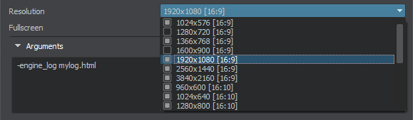

Resolution
(selected_res)
The resolution of the application screen. Multiple resolutions can be selected. The resolution that is clicked upon is set as default.

Path to the corresponding binary to be run. The binary depends on the type of build.Путь к соответствующему исполняемому файлу. Бинарный файл зависит от типа сборки .
This option is for the projects that do not use C# Component System.Этот вариант предназначен для проектов, которые не используют C # Component System .
Note that the binary is defined automatically, if it remains located in the bin/ folder. If it has been moved elsewhere or rearranged in some other way, the path to the file is to be set manually.Обратите внимание, что двоичный файл определяется автоматически, если он остается в папке bin/. Если он был перемещен в другое место или переставлен другим способом, путь к файлу необходимо указать вручную.
Arguments
(args)
Additional start-up command-line options.Дополнительные параметры командной строки запуска .
UnigineEditor creates the <project_name>.lconfig file that Launcher uses to run the app. If a user changes any parameters and runs the app, the changes are saved in <project_name>.lconfig. Closing Launcher without running it discards any changes.UnigineEditor создает файл <project_name>.lconfig, который Launcher использует для запуска приложения. Если пользователь изменяет какие-либо параметры и запускает приложение, изменения сохраняются в <project_name>.lconfig. Закрытие Launcher без запуска отменяет любые изменения.

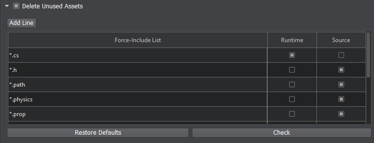

Delete Unused Assets
Удаление неиспользуемых ассетов#
This feature enables you to delete all unused assets from the final build. To turn it on, check the option near the Delete Unused Assets section heading.
Этот раздел позволяет вам указать ассеты, которые будут добавлены в вашу окончательную сборку. Вот как это выглядит:
The Build tool scans all assets of the types specified as wildcards (including location) in the Force-Include list (*.world, *.cs, *.fbx, *.prop, etc.), automatically resolving all dependencies (an FBX asset shall be checked for all meshes, meshes shall be checked for materials assigned to their surfaces and so on...). Thus, all assets in your project that are used by the assets of the specified types are collected and included in the final build.Инструмент Build Tool сканирует все ассеты тех типов, которые указаны при помощи подстановочных знаков (включая местоположение) в списке Force-Include (*.world, *.cs, *.fbx, *.prop и т.д.), автоматически разрешая все зависимости (в ассете FBX должны быть проверены все меши, в каждом меше должны быть проверены материалы, назначенные на его поверхности, и так далее). Таким образом, все ассеты в вашем проекте, которые используются ассетами указанных типов, собираются и включаются в окончательную сборку.
You can add more asset types to the list or remove existing ones by simply right-clicking on the desired line (a new line shall be inserted after the one you clicked on). You can also click Restore Defaults to reset the list to its initial state.Вы можете добавить другие типы ассетов в список или удалить существующие, просто щелкнув правой кнопкой мыши нужную строку (новая строка будет вставлена ​​после той, на которой вы щелкнули). Вы также можете нажать Restore Defaults, чтобы вернуть список в исходное состояние.
For each type of assets in the list you can specify whether to include runtime or source file. But be careful, as checking only Runtime for .png textures will result in ignoring the ones with the Unchanged option enabled (i.e. having no runtime), they simply won't be included. To check your list against such cases click Check, the following Check List window will open:Для каждого типа ассета в списке вы можете указать, следует ли включать файл runtime или source. Но будьте осторожны, поскольку проверка только Runtime для текстур .png приведет к игнорированию текстур с включенной опцией Unchanged (т.е. без рантайма), они просто не будут включены. Чтобы проверить свой список на такие случаи, нажмите Check, откроется следующее окно Check List:

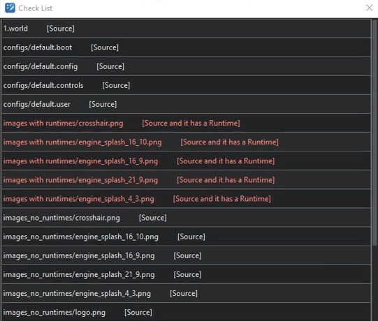

In this window all files found in the process of scanning are listed. The ones in white are ok, but the ones in red require your attention, for example, you may mistakenly choose to include source for an asset that has a runtime. So, be sure to look through red ones. The following options are possible:В этом окне перечислены все файлы, найденные в процессе сканирования. Белые — в порядке, но красные требуют вашего внимания, например, вы можете по ошибке включить исходный файл для ассета, у которого есть файл среды выполнения (рантайм). Итак, обязательно проверьте все файлы, выделенные красным. Возможны следующие варианты:
  • [Source and Runtime] - both boxes are checked (both source and runtime files shall be added).[Source and Runtime] — оба флажка отмечены (должны быть добавлены файлы source и runtime).
  • [Source] - when Source is checked and the asset has no runtime (only the source shall be added).[Source] — когда установлен Use Source и у ассета нет рантайма (нужно добавить только source).
  • [Source and it has a Runtime] (shown in red) - when Source is checked, but the asset has a runtime (only the source shall be added).[Source and it has a Runtime] (показан красным) — когда Use Source отмечен, но у ассета есть рантайм (нужно добавить только source).
  • [Runtime] - when Runtime is checked, and the asset has a runtime (only the runtime shall be added).[Runtime] — когда установлен Use Runtime и у ассета есть время выполнения (нужно добавить только runtime).
  • [No Runtime] (shown in red) - when Runtime is checked, but the asset has no runtime (nothing shall be added).[No Runtime] (показано красным) — когда Use Runtime отмечен, но ассет не имеет рантайма ( ничего не должно добавляться).
Force-Include List for the console mode is specified in the configuration file as a set of wildcards as follows:
