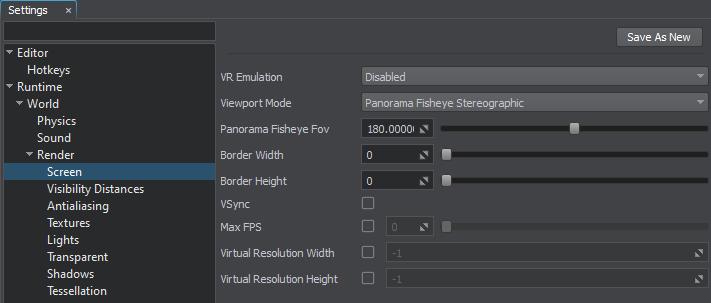

Screen settings
Screen Settings Настройки экрана
VR Emulation value indicating the current VR emulation mode. The FoV value in any selected mode is 110. Одно из следующих значений:
  • Disabled (по умолчанию)
  • HTC Vive (1512x1680)
  • HTC Vive Pro (2016x2240)
  • Oculus Rift (1332x1586)
Консольная команда: render_vr_emulation (API)
Viewport Mode viewport rendering mode. The following modes are available:
  • Default — default rendering mode.
  • Curved Panorama 180 — 180-degree panorama with curved edges.
  • Curved Panorama 360 — 360-degree panorama with curved edges.
  • Linear Panorama 180 — 180-degree linear panorama without distortion at the edges.
  • Linear Panorama 360 — 360-degree linear panorama without distortion at the edges.
  • Panorama Fisheye Orthographic — orthographic spherical panorama (fisheye) with an adjustable Field of View.
  • Panorama Fisheye Equidistant — equidistant (tru-theta or f-theta) spherical panorama (fisheye) with an adjustable Field of View.
  • Panorama Fisheye Stereographic — stereographic spherical panorama (fisheye) with an adjustable Field of View.
  • Panorama Fisheye Equisolid — equisolid (equal-area) spherical panorama (fisheye) with an adjustable Field of View.
  • Anaglyph — stereo mode that is viewed with red-cyan anaglyph glasses.
  • Interlaced — stereo mode that is used with interlaced stereo monitors and polarized 3D glasses.
  • Horizontal — horizontal stereo mode.
  • Vertical — vertical stereo mode.
If the panoramic rendering is enabled, underwater shafts and water line effects will be disabled.
Опция #1 установлена по умолчанию (см. выше).
Консольная команда: render_viewport_mode (API)
Panorama Fisheye Fov Field of View (in degrees) for the panoramic viewport mode selected at the moment.
Available only when the viewport rendering mode (см. ViewportMode) is set to one of the fisheye panorama modes (5-8).
Диапазон значений: [0, 360]. Значение по умолчанию : 0.
Консольная команда: render_panorama_fisheye_fov (API)
Border Width Width of the image border (in pixels), to be rendered outside the horizontal bounds of the screen to reduce artefacts of post effects. Ширина границы изображения (в пикселях), отображаемая за горизонтальными границами экрана для уменьшения артефактов пост-эффектов.
Border Height Height of the image border (in pixels), to be rendered outside the vertical bounds of the screen to reduce artefacts of post effects. Высота границы изображения (в пикселях), которая будет отображаться за пределами вертикальных границ экрана, чтобы уменьшить артефакты пост-эффектов.
Max FPS maximum FPS value, to which rendering FPS is to be clamped.
0 - disables FPS clamping. Both VSync, and Max FPS are actually about an additional idle period at the end of the frame. In case of VSync the Engine shall wait for the monitor to draw the whole image, while Max FPS enables you to specify any value for the delay (even a fractional, like 24.5). This clamping limit can be used for both debugging purposes and in the final build as well enabling you to smooth an unstable "jigsaw" framerate. For example, in case FPS jumps between 45 and 90, setting Max FPS to 45 may significantly improve your application's response visually.
Диапазон значений: [0.0f, inf]. Значение по умолчанию : 0.0f.
Консольная команда: render_max_fps (API)
Virtual Resolution Width Width of the virtual screen (in pixels). This option can be used to render video with high resolution (e.g. 8K) regardless of monitor's resolution. Ширина виртуального экрана (в пикселях). Этот параметр можно использовать для рендеринга видео с высоким разрешением (например, 8K) независимо от разрешения монитора.
Virtual Resolution Height Height of the virtual screen (in pixels). This option can be used to render video with high resolution (e.g. 8K) regardless of monitor's resolution. Высота виртуального экрана (в пикселях). Этот параметр можно использовать для рендеринга видео с высоким разрешением (например, 8K) независимо от разрешения монитора.
