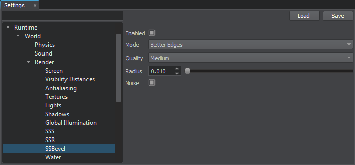

Screen-Space Bevel Settings Настройки фасок в экранном пространстве
Settings are applied to materials with the SSBevel state enabled. Настройки применяются к материалам с включенным состоянием SSBevel .
Enabled value indicating if the Screen-Space Bevels (SSBevel effect) are enabled. вкл. по умолчанию.
Консольная команда: render_ssbevel (API)

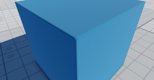

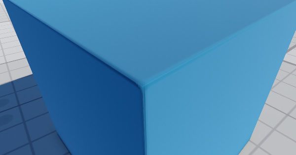

Mode rendering mode of the screen-space bevels. The following modes are available:
  • Better Edges smoothes vertex and surface normals of the object. In this mode, the relief created by using Normal Mapping will be smoothed along with the mesh edges.
  • Better Normals smoothes only vertex normals. In this mode, only edges of the mesh geometry will be bevelled. The mode may produce visual artifacts on the edges. However, they can be reduced by increasing quality settings of anti-aliasing.
To use this option, rendering of SSBevel (см. SSBevel) should be enabled. Опция #1 установлена по умолчанию (см. выше).
Консольная команда: render_ssbevel_vertex_normal (API)
Quality quality mode for the screen-space bevels. Одно из следующих значений:
  • Low - low quality
  • High - high quality
  • Ultra - ultra quality
Консольная команда: render_ssbevel_quality (API)
Radius size of the Screen-Space Bevel effect. To use this option, rendering of SSBevel (см. SSBevel) should be enabled.
Диапазон значений: [0.0f, inf]. Значение по умолчанию : 0.01f.
Консольная команда: render_ssbevel_radius (API)
Noise value indicating if the noise is enabled for smoothing bevels. It is recommended to use the noise with TAA (см. TAA) enabled to avoid visual artifacts. The bevel noise is applied at a certain distance from the camera (i.e. if the camera is too far from the object with bevels, the noise won't be applied). To use this option, rendering of SSBevel (см. SSBevel) should be enabled. вкл. по умолчанию.
Консольная команда: render_ssbevel_noise (API)
