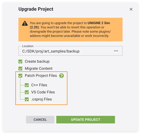

Upgrading your project to a newer version may sometimes require changes to project files (such as adding new files) or source files (such as adding include directives). These changes are most commonly related to integrating new third-party libraries.
To save you from having to make these modifications manually, the SDK includes built-in functionality to assist with migration. When updating your project, you can select which files should be automatically patched.
By default, all files are selected for patching.
