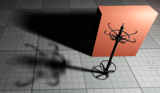

Penumbra Mode global quality mode to be used for rendering penumbra from all light sources by default. This mode enables simulation of real-world shadows by keeping sharp contact shadows closer to the base and softening the farther the shadow stretches away. Higher values produce softer shadows. When disabled, shadow edges are crisp and sharp (no shadow softness at all).
You can set penumbra quality mode or disable penumbra rendering for each light source individually. But these per-light quality settings are ignored when global quality is set to Disabled.
